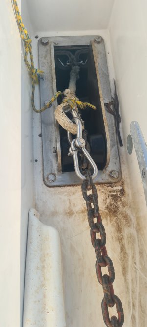

I've never used or even handled a soft shackle, and I know nothing about them so I'm looking for advice. Below is a picture of the bridle on my catamaran attached to the 10mm chain. My wife finds it very difficult to attach/detach the shackle and I'm wondering if a soft shackle would be easier. I'm happy to buy one to experiment and I just need to know what to buy - dia, length etc. Boat is 13m x 6.72m power catamaran.20240902_094109.jpg
Is the anchoring load going through that snap hook, because if so, snap hooks are weak and should not be used in any application that takes significant load? Compare the size of the pin on the snap hook to that on the shackle - it's tiny.
Here's an 8mm snap hook which looks about what you have. Working load limit is a pathetic 230 kg...
SNAP HOOK 8X80MM STAINLESS STEEL - Pinnacle Hardware
By comparison, a chain hook for 10mm chain has a working load limit of 2500 kg...
Mantus Chain Hook MK2
The Mantus chain hook above comes with a suitable shackle for connecting to your bridle. You only need to do it once and then mouse it. It's not a cheap bit of kit, but appropriate for the job and easy to use.

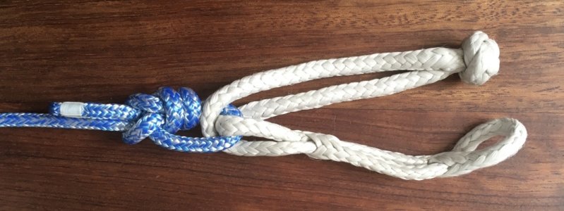

We have used a "high strength" 5mm soft shackle on our 10mm chain and it was easy to thread through the links. A reasonably long soft shackle is best for this application and this allows it to be a captured soft shackle and therefore it cannot be lost even if it undone.
The best solution is to make your own.

No. The photo below shows the arrangement.
The advantage is when the shackle is opened (as shown) it will still not detach from the snubber and drop in the water.
A 5mm soft shackle has a WLL of about 1000kg - when new - which is still only a fifth of the strength of the chain. Better than the snap hook and fine for good weather. However, they get abraded easily, and I should think especially so threaded through a link in a galvanised chain.
My knot guru says her 5 mm high strength soft shackles have a break load of around 7440 kgf so a SWL of 1500 kgf (using a conservative safety factor of 5:1.)
The soft shackle connecting the chain to the snubber does not need to be stronger than the chain, but it should be stronger than snubber. 10mm nylon has a breaking load of around 2000 kgf, 12mm is around 3100 kgf, 14mm 4000 kgf and 16mm 4800 kgf. However nylon has a significantly lower breaking load when wet and exposed to UV so in practice the break load will be even lower than these numbers suggest.
If you are worried about the soft shackle not meeting the chain strength (although there is no reason to consider this for a chain to snubber connection) 10mm G30 chain has break load of around 5100 kgf (a SWL of 1300 kgf) 10mm G40 6300 kgf (a SWL of 1600 kgf).
As you can see, the breaking load of the soft shackle will be significantly higher than any snubber that would be used on a boat using 10mm chain. The strength of the soft shackle should not be an issue although you do need to do the comparison (based on the snubber strength) if using to G70+ chain.
I would not be happy with that set up. The legs are equal which means the knot and associated loopwill settle right on the chain link. That will make it awkward to release. One leg ( the one with the loop) needs to be much longer so that the joint is 50% of the way down the loop. This is another reason the total loop would be better bigger rather than smaller. Say 200mm when closed
The bend was just positioned centrally in the photo to clarify how the captive part is threaded. There is no need for the bend to be central and the shackle will not settle on the same spot on a chain link each time. It can be positioned anywhere. Give it a try and you see what I mean.
There is no necessity to use a captive soft shackle, the captive part is just a nice addition that saves losing the shackle overboard if you are little careless.
