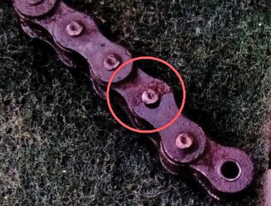

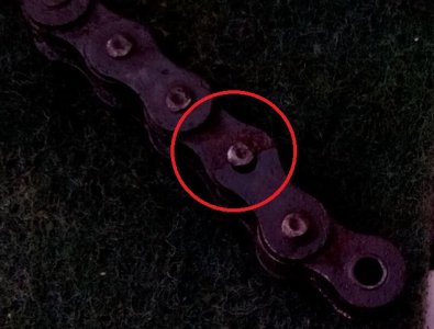

This was mine, I found it like that during a preventative revision of the whole steering (which I made once in 20 years), the chain was the original one so probably 30yo at the time. I might probably check it again in 10 years time, the problem is not all the chain is visible once one takes off the compass from the steering column, this half broken link was near one of the two extremities so not visible from outside. The usual contorsions are needed to take off the cables, pull them out of the pedestal, then it all comes out covered in grease and it s quite a mess. :(
