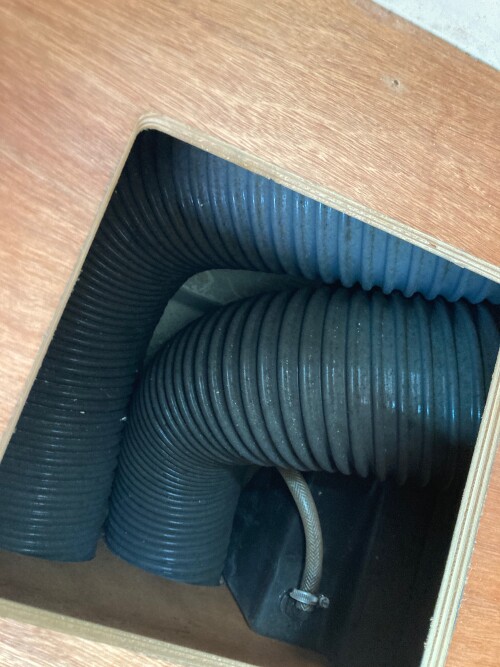

On the basis this may be useful to someone in the future (and it’ll remind me when I come to order it)
Exhaust hose is 89mm. 3.45m from transom outlet to waterlock. 0.75m from water lock to engine. Could probably get away with 4m as it does a loop under the transom over the rudder.
Engine seacock is 1.5 inches and the intake hose is 32mm. 2m is plenty.

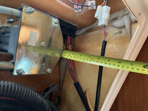

Measured up to check there was enough space to replace the cable steering with hydraulic because I wanted to add autopilot. Seems like there will be loads of space. I ordered a Hydrodrive kit (from Tenten Boats as they were by far the cheapest): Hydrodrive MU50-TF MRA inbaoird steering kit, 569,00 €
I looked at various options but Hydrodrive seemed to be well made, used relatively decent hydraulic hoses and was also the cheapest. Only downside is it has taken forever to turn up (and is still with DHL). Bill Higham are dealers for Hydrodrive in UK but their prices are stupid.
I think it's a Vetus tiller arm. Looking at the Vetus spec sheet I think I need to drill out another hole because the hydraulic ram will have less travel than the original cable steering.

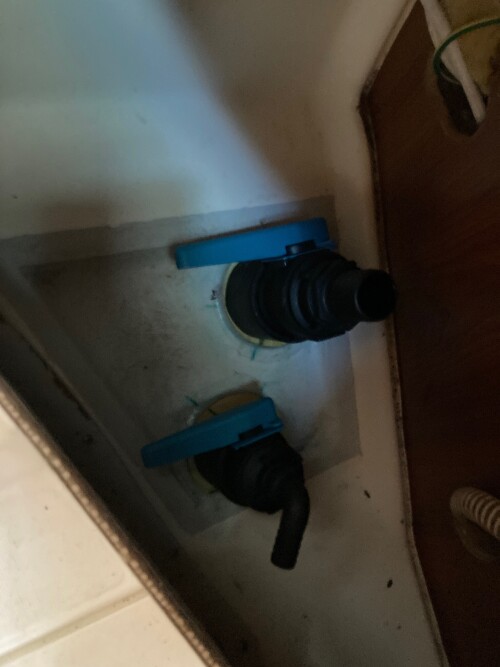

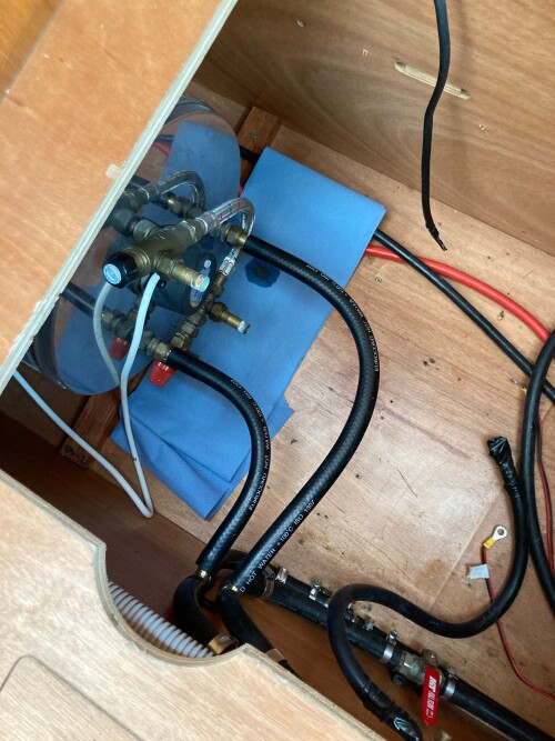

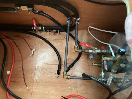

I removed this abortion the previous owner concocted from copper piping
And replaced it with some flexi hoses and proper tees. Obviously not connected up properly yet because I need to fit lots of batteries in this locker. At the moment the heating circuit tees off to go to the calorifier and the windscreen demister, I was debating if it would be better in series.

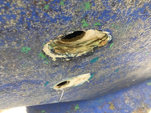

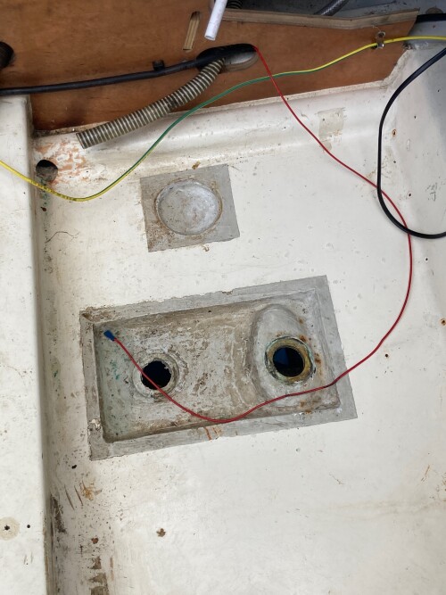

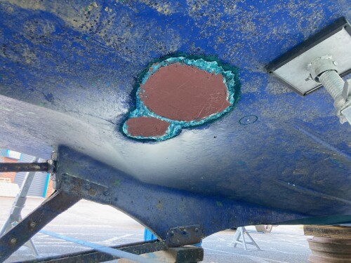

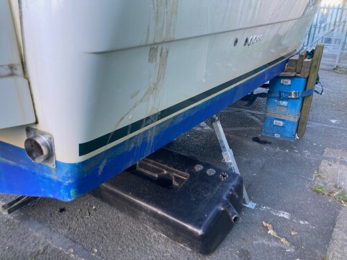

The old seawater intake, speed sensor and depth sensor. I'm not sure if it was factory fit but it was a mixture of sikaflex and fibreglass and I decided to rip it all out and move it closer to the bulkhead to free up more space.
Digging out rotten sikaflex and plywood.
Forgot to take any pictures of the fibreglassing but here it is being faired off. Ended up having to grind out a massive patch to get a sufficient taper to build it back up.
And inside had to rebuild the liner as well. Bought some fibreglass sheets off eBay as I couldn't be bothered to laminate my own.
And then faired it all off smooth. And prepared the hull for the new through hulls.

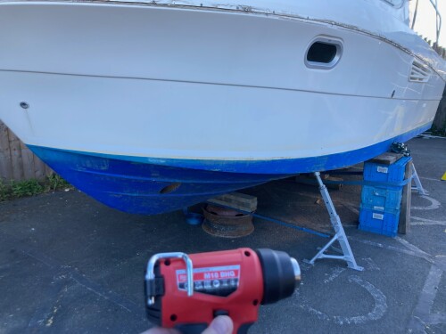

Used heat gun to remove the hull stripe, looks much more modern with it gone.
Then drilled out for the new engine sea water inlet and a Airmar DST810 triducer.
Spent ages messing around in the toilet adding fibreglass backing place to increase the hull thickness for the TruDesign through hulls.
Just need to sikaflex them in and should be good for the rest of the boats life.

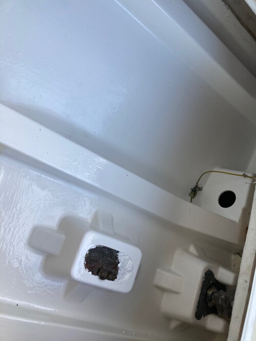

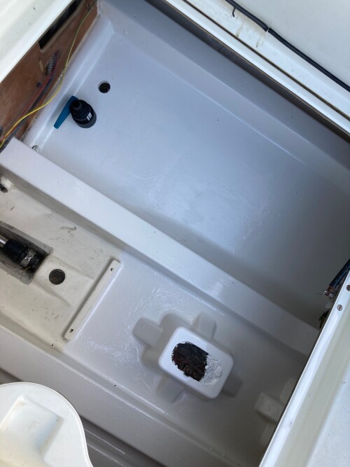

Then got on with flowcoating the lazarette locker.
Going to flow coat the plywood bulkhead as well to seal that up.

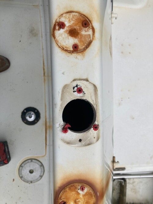

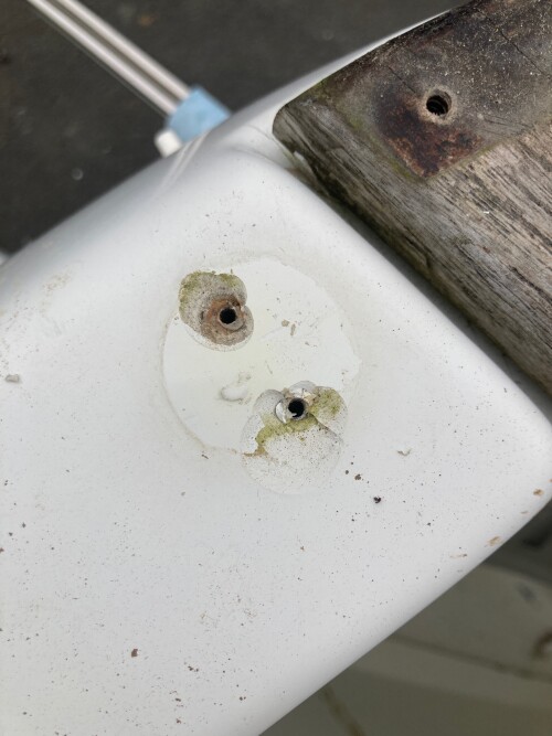

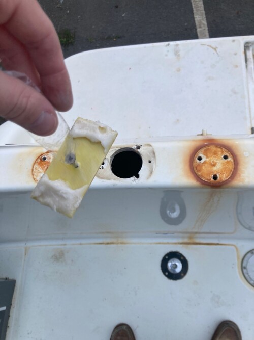

Stripped off all the paraphernalia off these planks so I can make some new ones from some iroko.
Not sure what on earth the previous owner of the boat was thinking when he was installing these accessories. Woodscrews and home base rawl plugs, what a hero.
I found a photo of the previous owner drilling holes in my boat
At least fibreglass is easy to fix.

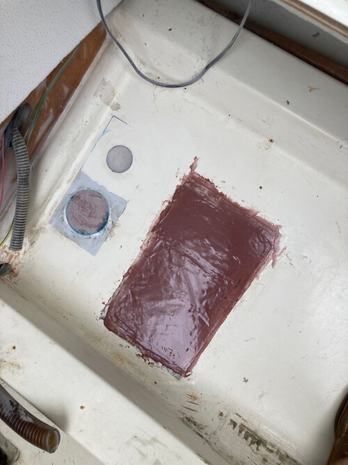

Thought I would make a start on patching the massive hole so it was dry for tomorrow.
I'm deliberately not removing the rust stains yet as it will make me feel better when i finally wash them away and the whole boat looks fresh again.

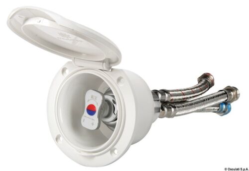

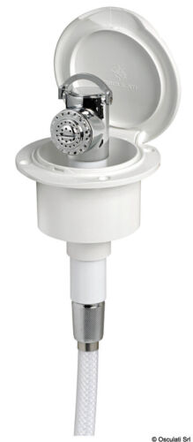

Could you point me in the direction of the supplier of your new transom shower fitting please? It looks to be the same as ours, which is in need of replacement.
These were the two I bought as I wanted the longer hose to use to rinse the cockpit down.
Boat Hot & Cold Shower Mixer Tap Classic Evo Housing Deck Water | eBay
Classic Evo Deck Shower Box White Housing Push Button Shower Head 4m Hose | eBay
But the hose part looks to have been the last one but there are various other on eBay like Osculati Classic Evo White Shower Box PVC Hose 2.5mm Flat mounting | eBay
