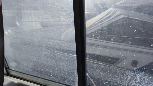

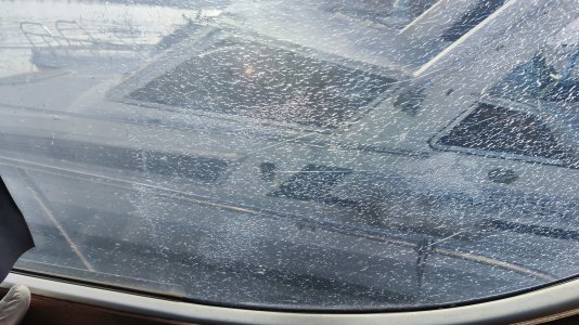

Jake, I have the same problem with my plexiglass as you do.
I came across your post while looking for ways to change the plexiglass.
I thought your work was fantastic and professional, so I read all 12 pages !
You tell people who want to do the same thing : Run away fast and far, but I don't really have a choice because my windows are very opaque.
You must have learned from your mistakes and you can surely improve the replacement procedure.
Could you make a short tutorial showing the step-by-step procedure ?
We already have all the photos of the process, but we're missing the method, for example, how to remove the aluminium parts or take out the windows, or where to buy the seals, how to remove the plastic handles on the sliding part, etc.
With these instructions, I'll see if I feel capable or not. I'm a DIYer, but nowhere near your level.
Thank you in advance.
Robert

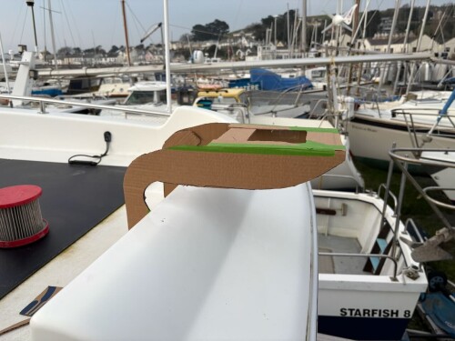

Had a bit of an interlude over the winter but it's meant to be going back in the water in a week or so :eek:

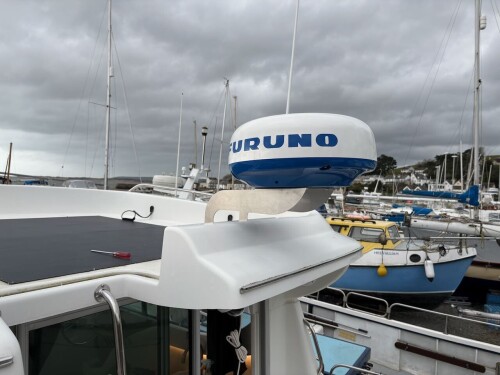

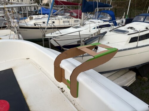

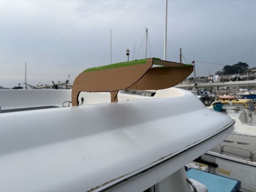

Did some cardboard aided design today for the radar bracket. Going to fold it up out of 3mm stainless.
Also did some testing of the radar, confirmed that it can talk to the windows 11 PC running timezero. All seemed to work fine

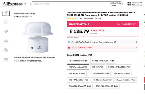

Ordered a dodgy chinese wind sensor, still need to decide how to convert it to n2k.
The MF805 rides bow high, you need to fit the radar so at rest it points down. If not, you'll miss a big area in front of the boat, as seen here.
Fitting it at the back also risks losing a sector too. Fitting at the front makes it easier to through bolt the bracket.

I’ve been contemplating the angle, I think I might just make it adjustable. What speed you cruise at also makes a big difference obviously.
I thought about having it at the front but I think it will look much more in proportion at the back, it already has a massive forehead 😂
The wind sensor spits out NMEA0183 sentences over RS232. To make the wiring easier I’m going to connect it to an NMEA0183->NMEA2000 converter so I can just plug it into the network rather than having to run another cable all the way down to the helm.
The Windows pc actually has two native RS232 serial ports, but as said getting to them is a pain and I’d then have to get SignalK to rebroadcast the wind info onto the N2K network.
Will let you know how it works, the other options were a Calypso at about £500 or Maretron WSO200 for similar.

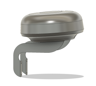

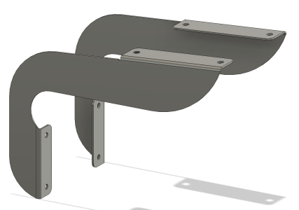

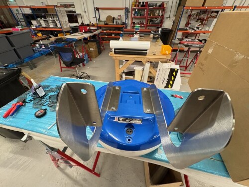

Drew the bracket up for the radar
Then ordered some stainless, will bend it up next week.

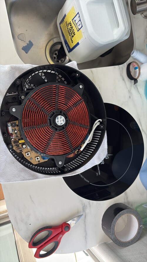

The induction hob was flaky and the seller had sent me a replacement some time ago. Swapped it over today. Had to disassemble it to pull the cables through.

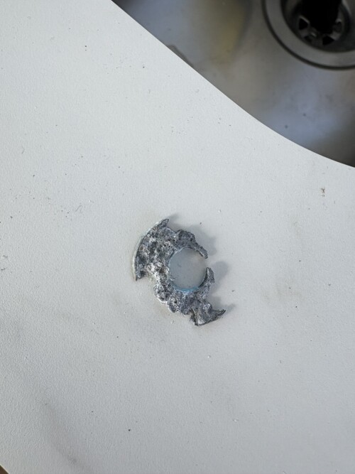

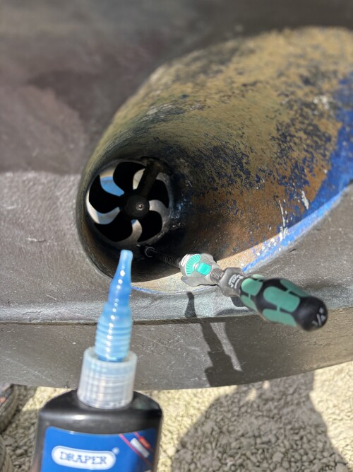

Swapped the anode on the bow thruster.
Think I had got my moneys worth on the old one

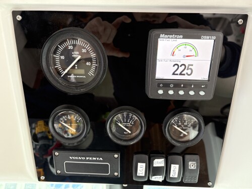

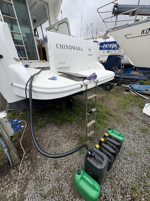

Emptied my bank account into the tank. The diesel transfer pump inside the lazarette that sucks direct into the tank is the best thing ever
Full

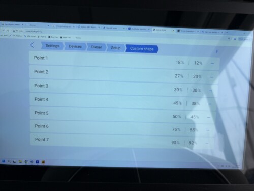

I filled the tank 20l at a time to get a calibration curve I could enter into the Cerbo

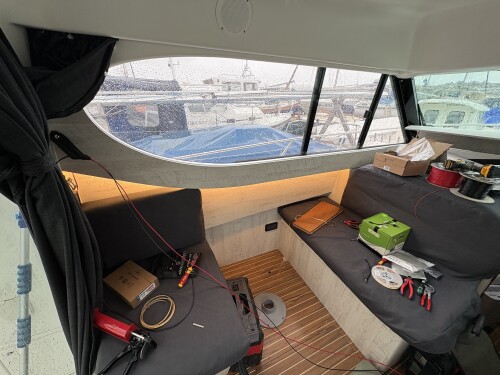

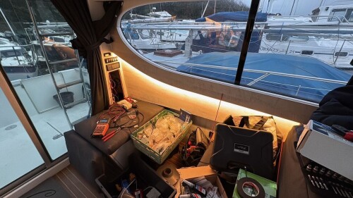

Fitted some bling LED strips under the side panels
Still need to finish wiring them up and have just ordered a 12v regulator but I think they look quite good

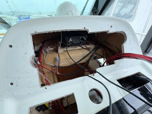

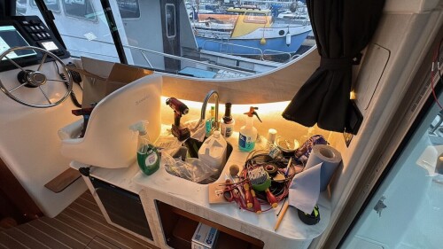

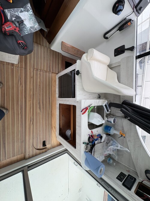

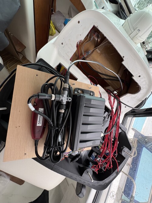

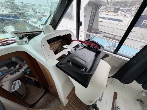

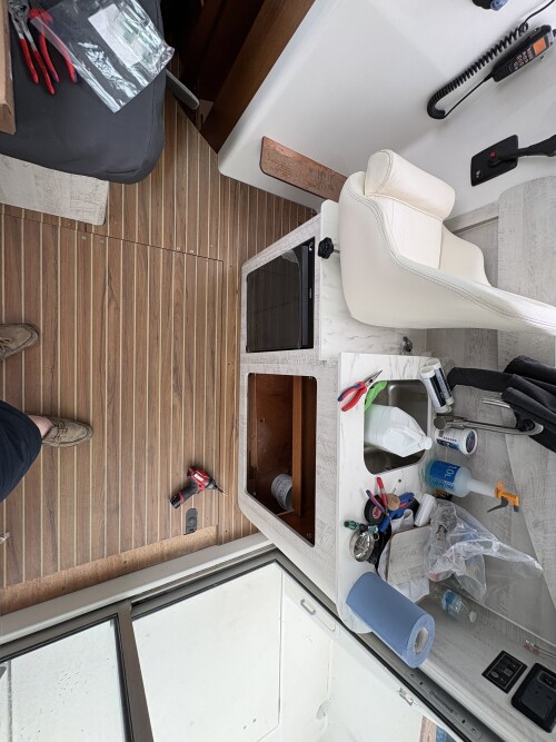

Then pulled the dash out
So I could get to the VHF radio and the NMEA converters behind it on this shelf

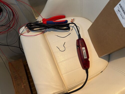

I originally fitted a nmea2k to serial converter, but it turns out that isn’t compatible with Furuno TimeZero. So had to replace it with the USB variant

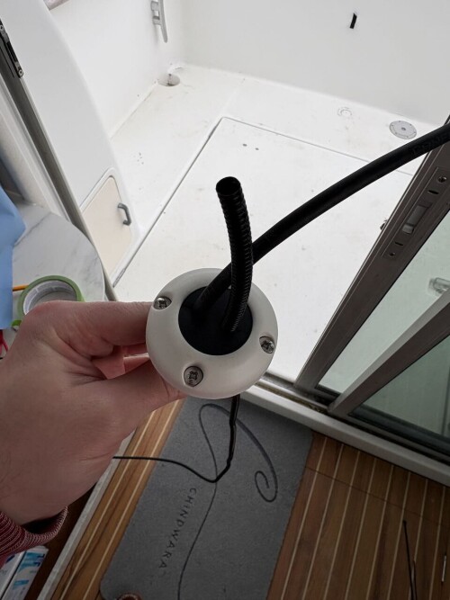

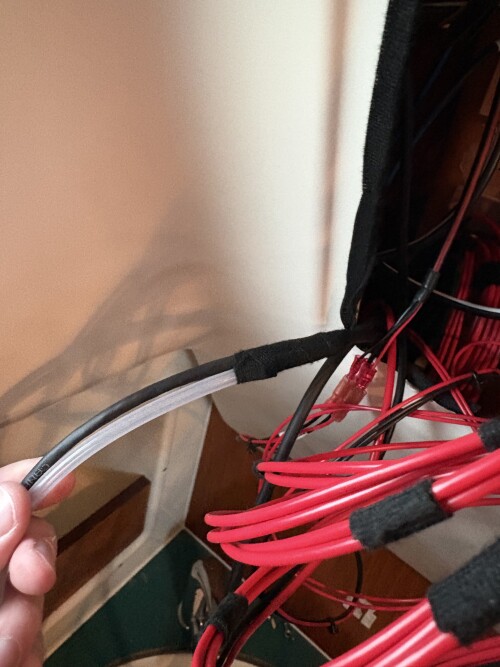

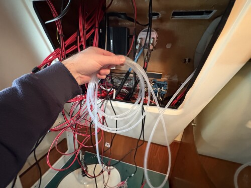

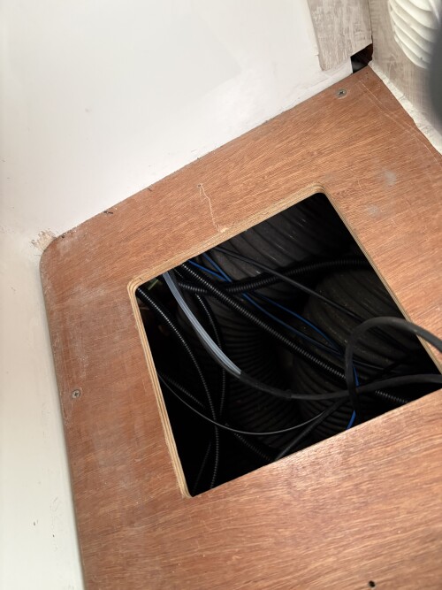

Then had to pull up the floor for the umpteenth time to feed through the pipe for the windscreen washer jet.
The pump is in the dashboard but the tank that will hold the washer fluid will go in the bathroom cupboard
Used another wire to fish it down
Success. Forgot to bring the tank with me so that will have to wait for another day.

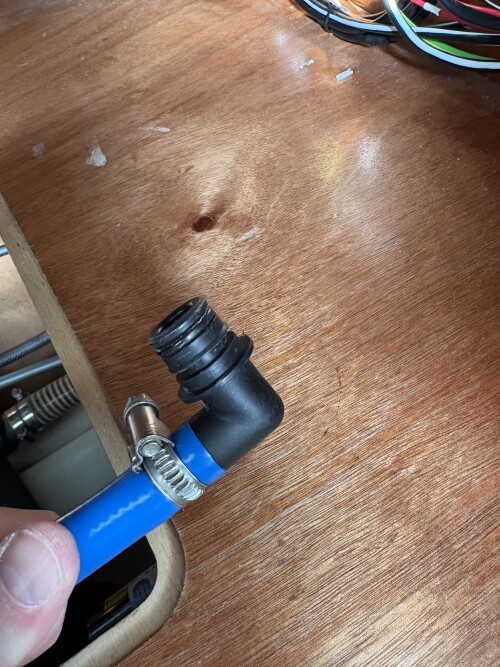

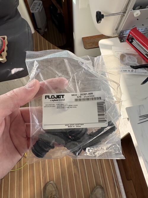

Ordered some new ‘quadport’ connectors for the water pump as the old one was worn and dripping
Fitted
But then I realised the pressure switch on the pump is dodgy so I think I will just order a new one 😩

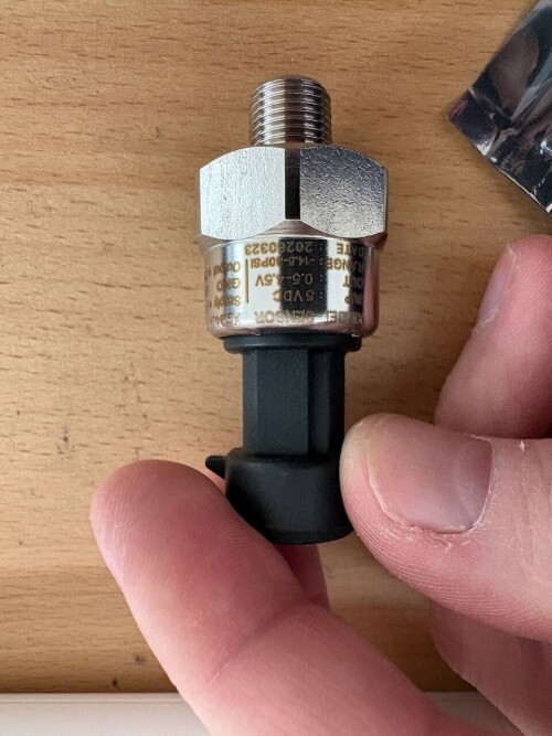

Chinese vacuum sensor arrived so I can monitor fuel suction pressure. Should tell me if the filter is getting blocked. Plan to connect it to the AlbaCombi.
It's actually 12V input, it just says 5V on it according to seller.

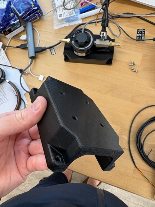

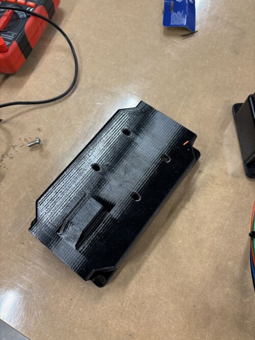

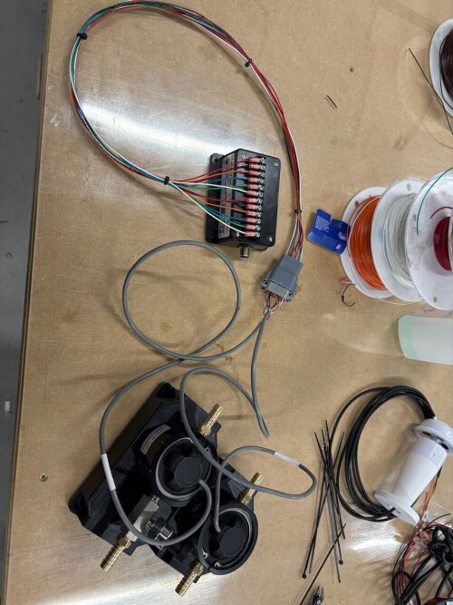

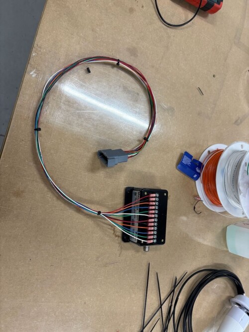

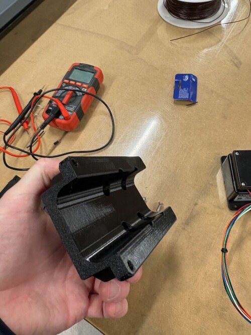

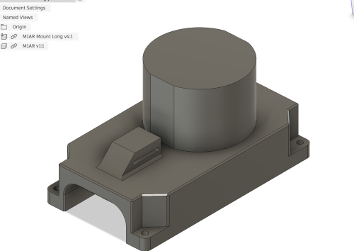

Designed some brackets for the Maretron fuel flow sensors to sit on
Then printed them
Then wired them up with a Deutsch connector to make it easier once it's on the boat:
Complete assembly
Mount for the fuel vacuum sensor goes after the flow sensor. There are two flow sensors, one for the fuel return as well.

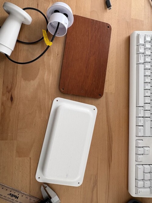

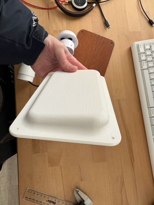

Then 3D printed a new cover for the windscreen wiper motors, the original don't quite fit any more as the motor hangs down a bit. In hindsight these are far too deep but it doesn't make any difference.

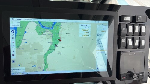

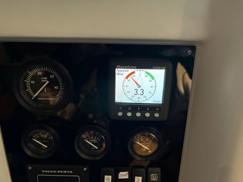

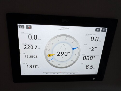

Then tested my china special ultrasonic wind sensor:
Seems to work in TimeZero.
Connected using an Actisense NMEA0183 to NMEA2000 converter. It worked immediately but by luck because the baud rate on the sensor is 9600 but the Actisense defaults to 4800. I changed the Actisense to 9600 (as it was easier than changing the sensor itself) and it started to update much more frequently.
And also shows on the little Maretron screen as well as the Raymarine Axiom

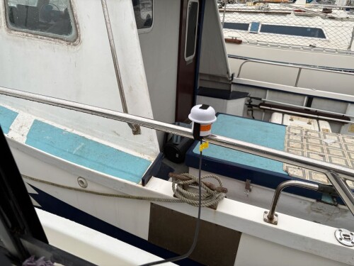

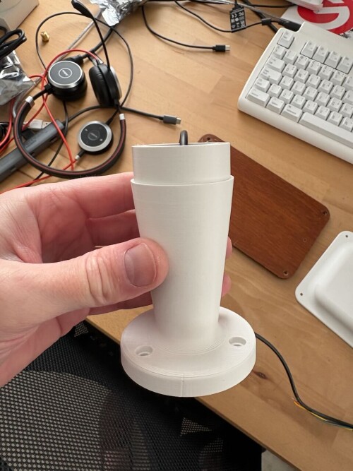

Then 3D printed a little mount for the wind sensor:

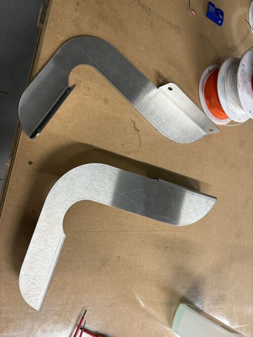

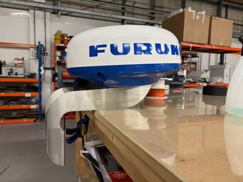

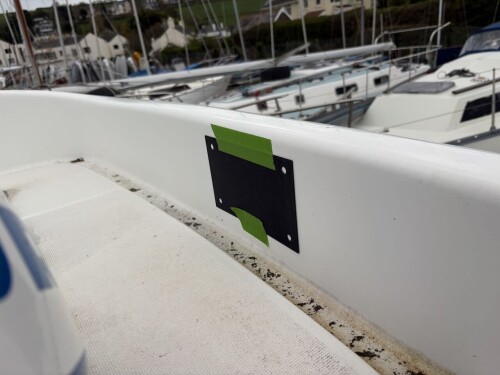

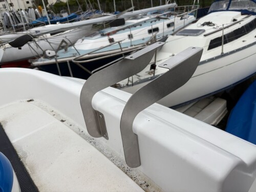

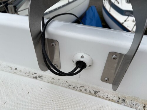

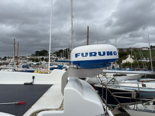

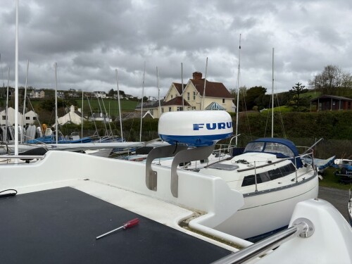

Then went and cut and bent my radar brackets
Seem to fit:
Not sure if they will be strong enough, may have to remake out of thicket stainless.
No idea if the angle will be right, in the end I took a guess and will just cut them again if I end up needing to tweak.
I'm also going to attempt to mount it backwards (ie. 180 degrees opposite to how it's meant to be mounted) as then the cables will be much more hidden. It looks like you can enter 180 degrees as an offset in the radar configuration to set it back to normal.
Stainless bolts should be arriving tomorrow and I can get some of this stuff fitted. I did also finish wiring the LED strips on the boat but it took me so long I was embarrassed to take any pictures.

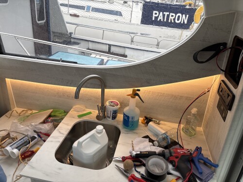

Finished wiring up the LED strips. Had to fit a 12V regulator as they seemed to get quite hot at 14+ volts.
Pleased with how they have come out.

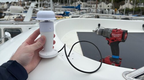

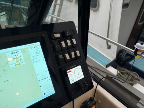

Then fitted my wind sensor
Forgot to take one of it stuck down but it seems to work and matched the weather forecast.
Works on the Raymarine screen too. Anyone know what the blue markers are for?

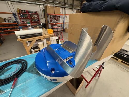

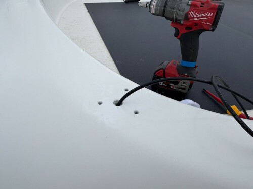

Then started on the radar. Printed a guide plate to get the holes in the right place:

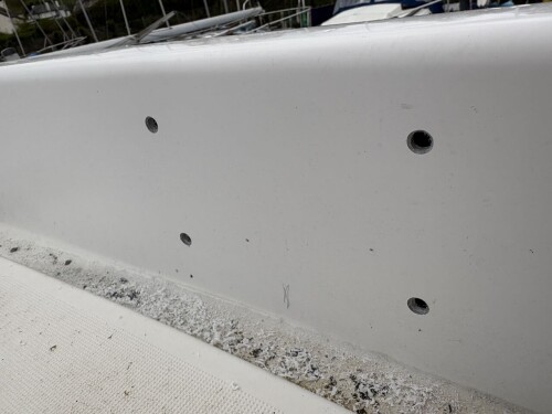

Seems to fit..
Not sure if it's quite high enough. But it's trivial to cut another bracket though once I have tested it.
Need to disassemble it tomorrow and replace the bolts with A4 ones and seal it up.
Not sure if it's tilted forward enough, the boat is pretty level on it's stands.
Then prepped the cable gland
And mounted it:

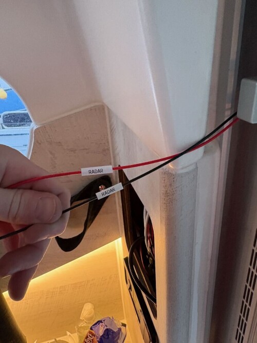

Then labelled some wires when it got windy

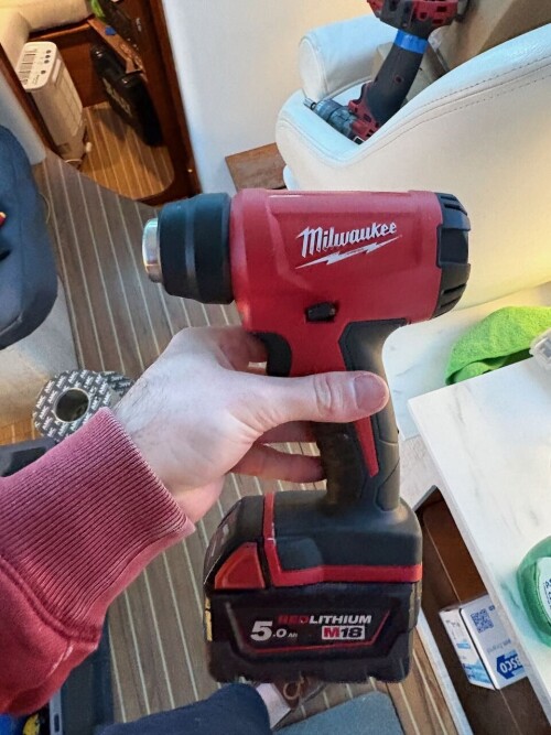

Cordless hairdryer :)
