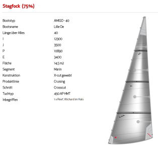

When we renewed our headsails two years ago we went with the combo of a 150% genoa on the roller, and a hank-on 75% blade staysail.
Sure, roller furling would be convenient also with the staysail, but we do remove the inner forestay occasionally when sailing upwind in lighter conditions (so we don't need to furl the genoa to tack).
We've ended up using the staysail quite a bit, especially for upwind work in higher winds or when we need to short-tack in a narrow channel (the smaller sail comes across a lot more quickly). The sail has also one reef which we've never used. It's been fine to about 38kt so far.
We switched our whisker pole to a telescopic model so it suits for poling out either of the headsails. Poled out staysail and main on 2nd reef is a sweet setup for winds over 30kt from astern.

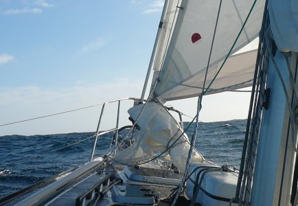

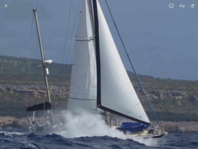

Making full use of my staysail going to weather received_472956182210411.jpeg

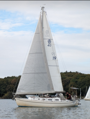

Here's the genoa

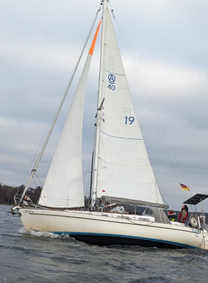

And the staysail (and winter sailing, though in mild conditions, as evidenced by the Christmas hats)

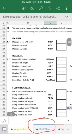

Been at the boat this weekend and measured up distance from mast to inner forestay and again from inner forestay to front of jib track, length of inner forestay and finally length of luff of current Genoa at second reef.
Is there an app / website / programme available where I can upload these dimensions plus the dimensions of prospective sails for sale to see if they would have decent sheeting angles?
Alternatively I’ll have to look out some graph paper and sharpen some pencils!

If I remember correctly, when we applied for an IRC rating a few years ago, the application was completed by filling all the measurements into a spreadsheet and as a check, the second tab used to show a diagram of the sailplan as per the measurements you had input.
This gave a nice double check that your numbers were reasonable, but RORC Rating in the UK now seem to have an online form only..
I'm on the mobile phone at the moment so can't fully check, but it looks like some countries still have a spreadsheet for rating applications.
Download the excel spreadsheet from Irish Sailing, put your measurements into the first tab and then look at the second tab called 'Sail Plan'.
https://www.sailing.ie/Portals/0/documents/2022/Racing/IRC 2022 New Form.xlsx

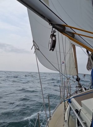

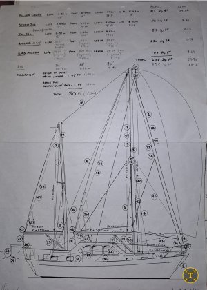

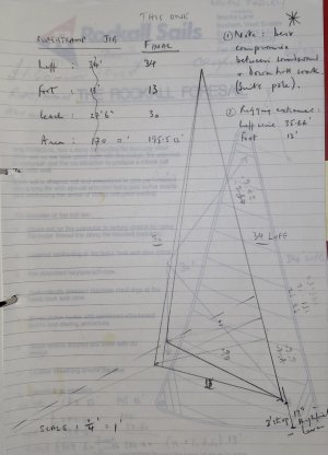

Get a scale drawing of your boat including sails if possible, and use it to establish possible sail shapes that suit your foretriangle (with extra stay). Important to understand the range of sheeting angles and you can adjust the height of the wire strop at the foot of the sail. Not certain that it needs to be especially heavyweight - mine is similar to my other sails.
Diagrams from my boat to illustrate.Screenshot_20240818_213941_Gallery.jpg20240818_210858.jpg
