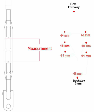

If you do decide to do a shroud at a time. Make a diagram like the following before starting using a cheap digital caliper. That way you can loosen all the rigging slightly, fit your boots, then re-set the rigging to where it was before you started.
