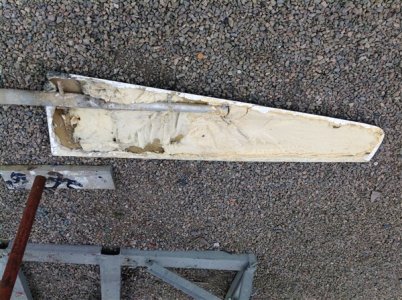

I’m a little surprised that nobody questions the. condition of the average boat’s GRP rudder. I bet most of them are “wet” and that the remaining strength is much less than it was when new.
Especially when you look at all the GRP rudder rebuilds and the crevice corrosion at the tang rudder shaft connection

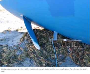

Looks like some level of sacrificial design is already the case ....
https://www.sailmagazine.com/diy/rudder-awareness

Sacrificial rudders are used by some boatbuilders, but they typically have a fracture point around 1/3 - 1/2 of the rudder length. The idea is that if the rudder strikes an object to lower portion will break away, but not damage other components and leave enough blade that the boat can be steered. This is not a great help with the current orca problem, as they would likely attack the remaining rudder blade.
