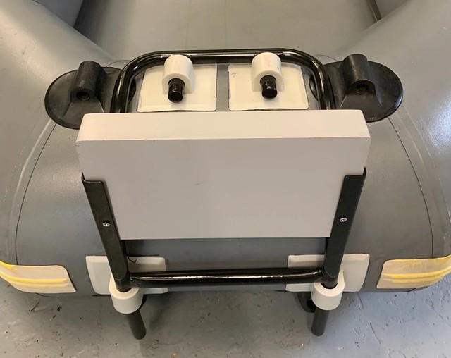

When I finally tried my Redcrest's engine bracket on the Redstart today, it was plainly too big - a bracket of the same design but tighter radius is needed. Unfortunately, while Redcrest brackets seem to be quite common (though expensive), you seem to have to find a whole Redstart for sale, to buy an engine bracket which fits one.
Has anybody tried this retrofit version? It's not a giveaway but at £50 plus perhaps another £20 for the extra sockets, it's no costlier than finding one of the elusive originals.
