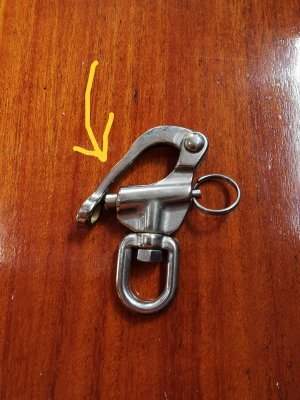

I have been using snap shackles for our spinnaker. Crucially, also for the spinnaker head.
Last week, that shackle failed (see attached) - the forces involved bent it. The result was a rather dramatic dunking of the kite in the water, in a large swell, not too far from waves breaking over some submerged rocks (we were not in danger of "touching", but the breaking caps were scary and may have been dangerous). It took a long time to retrieve the large improvised sea anchor. Fortunately, the lines got tangled in the hydrovane rudder rather that the main rudder (or sail drive) and were relatively easy to deal with, eventually.
Some minor tears to the spinnaker caused by snagging against stanchions, on retrieval.
Luckily there were two of us, and we were able to deal with the issue.
Anyhow. Lesson learnt: use a better arrangement at the head. I am going for a halyard shackle. I was wondering if a simple bowline would also be a viable alternative (any views on this?)

That looks a pretty cheap and nasty snap shackle. The sort with the central hinge pin are stronger. Problem with a bowline is they can shake loose. A buntline hitch would work, but they tend to jam and are hard to undo.

I had a couple of shackles identical to the one in your picture and they were really not up to the task (I eventually kept them for the lee clothes), a Wichard one would be perfect (or similar brand, Tylaska if you are rich :)

This is the sort you need. Bowlines are possible, but depending on exactly how your halyard exits at the top of the mast, and what is up there you do have an increased risk of it hooking over something and refusing to come down. I wouldn't personally.
