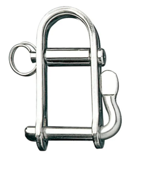

If we are talking about the spinnaker halyard, why not use a halyard shackle?
Failsafe.
A halyard shackle isn't failsafe. If it fails it fails, there is no safe aspect to the failure. It is perhaps less likely to fail that a snap shackle but it cannot fail is such a way that there is a safe outcome with the system still able to operate.
Consider also your other uses of the spinnaker halyard, if any: for example, sometimes with the sail still in the bag at the bow, I hook it to the sail head grommet at the same time as the upper lifeline (for example while arranging the guy/sheet), or when the sail is lowered and thrown inside the boat and the halyard is removed, it can be useful to quickly make it fast somewhere nearby, etc. All temporary arrangements where a snap shackle is a lot more practical than other means, in particular as it can often be used with only one hand.
Show me a photo of a failed halyard shackle. Or explain how it can fail.
Probably because of the wrong choice.

Anyhow. Lesson learnt: use a better arrangement at the head. I am going for a halyard shackle. I was wondering if a simple bowline would also be a viable alternative (any views on this?)
That looks like it's been bent by being loaded while not in line with the load?
'Capsized' on a deck eye or something and tensioned up?
Even quite small snap shackles have quite high breaking loads, but if you jam them in a ring and pull at angle, here endeth the warranty.

As with lifeline tether hooks, jam it in a fitting and give it some twisting tension, that's quite likely to break it.
That split ring looks nasty. Could be replaced by machine screw and nyloc nut
