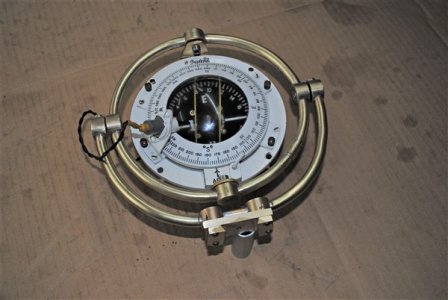

If you look at the picture of the gimbals I made for my Sestral compass you will see that I made the bracket in brass.
I found a piece of flat brass & just cut & filed it to shape. This is quite easy , being brass. As you can see I bolted the 2 splayed bits by Tapping & screwing them to the correct angle. If you can silver solder then easier still.
I already had 2 brackets, one in the cockpit & one in the cabin, so I just needed to match those.
It is not hard if you have a few tools.
You can get a piece of brass from M-Machines or any model company. Perhaps a scrap yard. I cut my piece from a lump of brass angle & the 2 splayed bits from a piece of hex bar.
You just need 2 pieces of plate. One cut to shape & splayed. One larger back plate. Silver solder the 2 together or tap & screw them. Drill the back plate for fixing screws to mount where needed
It just made an interesting weekend project
