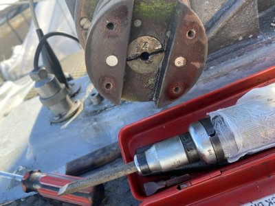

Do the below look excessively greased, please?

Any that gets on the deck is definitely excess....
One lesson I have learned is that when lifting the drum off, put a hand underneath. Otherwise the bearings that are between the drum and the spindle drop out unexpectedly and may bounce off the deck into the water. Ask me how I know!

Roller bearings used in an application where rotational speeds are low do not need any lubrication, unless to inhibit corrosion. In fact the presence of oil or grease can prevent their correct function by permitting skidding. This in turn can lead to flats being formed on the rollers and then they certainly won't roll. Compared to the roller bearings in, for instance a car's transmission, the winch bearings are fairly soft. This is because they are manufactured from corrosion resistant materials which are generally incapable of being hardened to the requirements of those in a car's gearbox, which is a very different environment, where oil or grease is necessary to dissipate heat and prevent corrosion.
The Lewmar video is IMHO a very good demonstration of the maximum amount of lubrication that could be applied to a winch.

I do hope you are not doing as he did because you will end up with zero grease. He's demonstrating a method, not doing the actual job.
