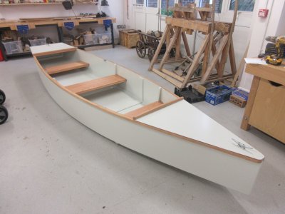

Built a very light dinghy using two sheets of 8by4 4mm ply……no grp just good joints and well painted…….just one central mound and bow and stern using 9 mmply….pine gunwhales and other parts

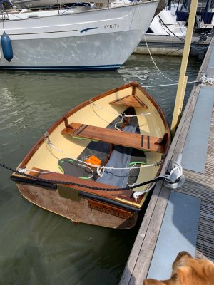

That looks lovely! Just the ticket for pottering around an anchorageI have just finished my second tender - picture below. I had the same concerns as you - weight as I get older , good to row ( considered a sail but decided no) or motor, strong and long lasting.
I decided against ply because ply is quite heavy. Instead I went for 6mm cedar strip- bought the plans for about £50 , the strip is bent around frames then the frames removed, and then the hull is glassed, leaving an extremely strong monocoque.
The dinghy lasted 18 years until a 50’ boat lost control and crushed it.
The design allows for a centre board and sail plan and the length is adjustable just by altering the frame spacing - 8ft to 12 ft is feasible.
Red cedar doesn’t rot easily ( hence used for garden sheds! ) and so you don’t have the same worry as you might with keeping water out of ply.
It’s not the cheapest construction and I don’t claim any great skill at building. If you want more details just pm me
Ist dinghy after 15 years use and new one.
