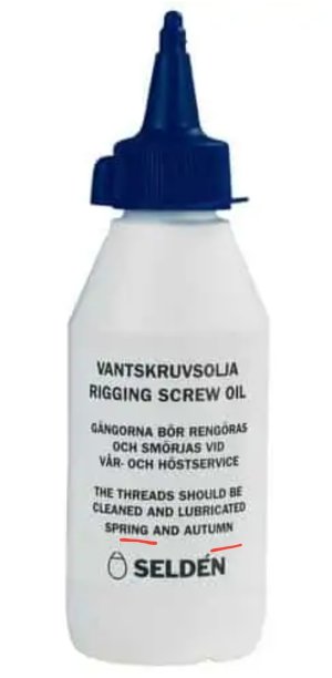

One of my each winter to do's is to loosen turn buckles and grease. Then return to original position. ol'will

Ta, any particular kind of grease?
Try lanocoat or something similar if bronze against stainless or bronze......if stainless on stainless then something like this.....https://www.cromwell.co.uk/shop/lubricants-and-chemicals/lubricants/anti-seize-lubricant-tube-85gm/p/ROC7706431H?gad_source=1&gclid=CjwKCAjwoPOwBhAeEiwAJuXRh8rmVOGZpyOqQTJM6Mej-ULIwAiFLa6Wmotmfa3BwOOfig41xWrR7RoC0IkQAvD_BwE

IMHO opinion whatever you have, I use axle grease. ol'will
This is indeed my general policy when it comes to grease.
I looked up the pot of magenta stuff that I inherited with the boat and it mentioned being suitable for immersion in water - like the bearings of boat-launching trailers and stuff like that. And copaslip is good for high temperatures. So I rather feel like that is most eventualities covered.
