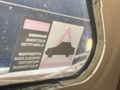

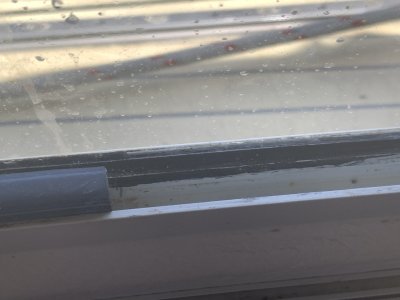

How might I best reseal these windows?
Notice from the photo how the pane of glass is inside a channel. Once the frame is out of the bulkhead, the upper and lower part of the frame come apart and then the pane of glass is removed. Only then can new sealant be put in and then the two frames brought together and reinserted back into the bulkhead. Does that make sense?
So given that, I’d struggle to use butyl tape too reseal? I’m hesitant to just use a sealant like Sikaflex for it to age and degrade relatively quickly.
Would a bead of butyl sealant in the channel work and then when the window pane put back in, and the frames brought together, it would hopefully squeeze out of all sides?
Suggestions welcome.

Exactly the same as mine. The frames need to be split and cleaned, the glass also. Mask off both glass and frames with tape. Inside the frame there will very likely be small fishplates with small alloy screws on the outside that clamp the fish plate to the frame. The two halves of frame are held together with the fishplates and screws. Mine were shot and new ones were made. The objective is to seal the glass in the middle of the frame with one of the UV resistant glass sealants, where the frame is filled with sealant and dressed with a chamfer so that any water runs off the frame. The sealant needs to fill the frame, in my case, water had penetrated the frame and corroded a hole in teh bottle of the channel. This is not fixed by having sealant in the frame. Mine have been in place for 6 years and are bone dry, with Scapa 3507 bedding tape between the frame and hull.
Mine were refurbished by Hadlow Marine Marine, I did not do it. The original frames had rubber seals that were compressed to hold the glass in place. they were binned.

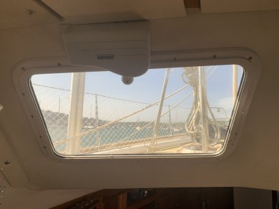

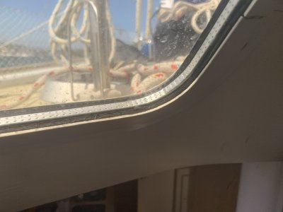

Here is a photo of the double glazed front window. I couldn’t get a pre made double glazed window since the two windows need to be inserted into each channel in the frame.
Did you ever find out the original manufacturer?
