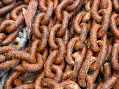

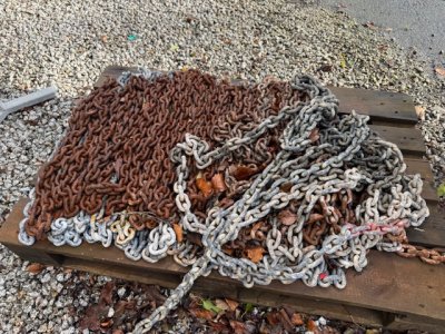

100m of 10mm chain purchased approx 10 years ago. In turned it around a couple of years ago so that the first 50m and still galvanised. But the last 50m, which was the first 50m is rusty.
Upon inspection it all appears as surface rust but is this likely to be purely cosmetic or something I need to deal with.

The chain will now continue to rust - it will only get worse. However the rust looks only superficial and if you use the rusted portion then usage will clean the chain up, and then it will start rusting again in the chain locker. Ideally use the chain, wash with fresh water and allow the chain to dry (crack open the locker hatch to allow air circulation) and you will reduce the rapidity of corrosion. Rust holds water, its porous, cleaning the rust off, with usage) and having clean steel will reduce the rate of corrosion if you clean and dry the chain (as much as possible) Don't keep textile (rope) in the same locker - it holds water, commonly salt water. If the chain sits on top of salty rope, the chain will rust more quickly. Make sure the locker is clean and drains well.

The majority of my chain had worn galvanising like yours. But on close examination I found a few links with very flaky surface and some degrading of the steel. The chain is usable but the ultimate strength of the chain must be reduced. I am replacing it because the moment you need confidence in the strength of your chain is the time you least want to have doubts in it.

If you are not using your yacht then flaking the rode on pallet, washing it with fresh water and leaving it under the hull (if on the hard) will help prolong life (of the chain). Leave it in a dank, salty locker - it will corrode more quickly. So wash out the locker - with fresh water. If you wash your chain with fresh water, dry, store in a sealed oil drum then diesel is a good protective coating (that's how many chains are shipped)

Conversely if the rust comes off in flakes the chain will have lost sufficient mass to condemn it - but will be more than adequate to secure a doberman :)
