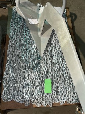

YGSL have my chain at the moment. It's costing me £500 for 80m of 10mm chain and a 30kg anchor. They charge £2 plus vat per kilo. They blast it then regalv. Just off M1 at Rotherham. They aren't quick though. I have been waiting a month now
I suspect they also pickle with acid.
Does that cost include delivery of the chain, both ways?

No. I dropped it off and am picking it up on Wednesday.
Regards
Moving chain, especially 80m of 10mm chain is a thankless task - well done.
In a 'similar' exercise, we were down sizing the chan, I, unthinkingly, dropped (only) 50m of 8mm chain into a hefty plastic box in the dinghy and took it to the beach, nearby which our car was parked). I then realised packing it in one box was no use, I could not lift it. :)
Thanks Jules, let us know how it looks (a bit subjective I know) and in the fullness of time, say 2030 :), let us know how it performed
