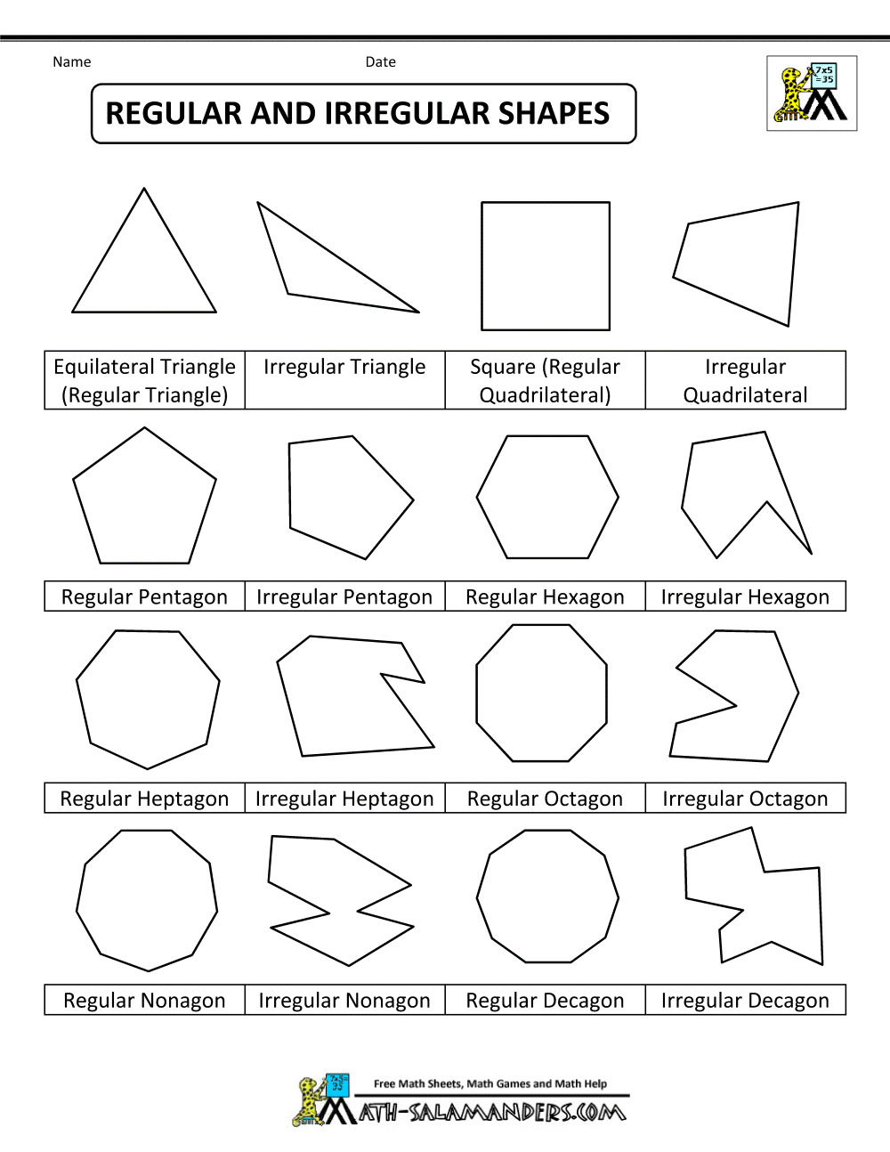

An irregular shape shape cannot be defined by its dimensions.
Some examples of regular and irregular shapes.
It not an Aristotelian riddle it your lack of understanding.
