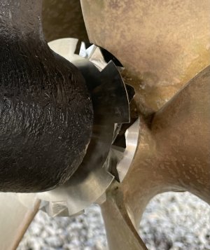

I’m trying this… no idea how good it is… yet
Better than nothing but relies on chance rather than physics to catch and cut anything serious. Thge serrations are arguably better than plain because of the greater cutting area, but they mimic the blades of the real thing without understanding why they are that shape.

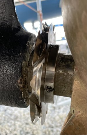

Another viewing angle… I can kinda see how it should work… rope gets caught, p-bracket is static, prop and cutter are rotating, rope is tightened and pulled into channel in cutter, vertical blade edge cuts rope! 🤞
Compared to the Stripper ... I think the gap is insufficient to allow the rope to drop in and get trapped / cut ...
The Stripper has tapered cutter blades specifically to allow the rope to get into the cutting area ....
