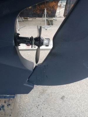

They are better than nothing but as tests have shown they are a bit hit and miss. You can often make room for a scissors type cutter by moving the shaft back with a spacer between the coupling halves

This is probably the wrong forum to go on about fin-and-skeg designs, but I'd have had to cut a chunk out of the rudder. Clearly what you say is true for some installations though.

No problem - that is why I said "often" - sort of assumed you might have a MOBO many of which have shafts on P brackets. Non fin boats are OK - photo is of mine with a Stripper and feathering prop fitted where a cut out of the (modified) rudder was necessary. Earlier boat of similar design also needed a cutout in the rudder. Appreciate that it is not possible/desirable to do this on all boats with limited clearance in the aperture
