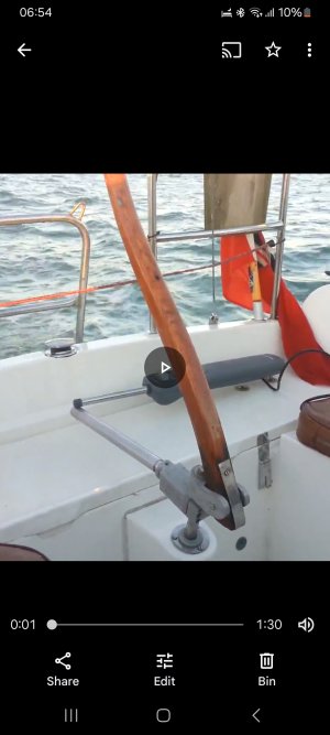

My tiller pilot is mounted in the aft end of the cockpit. Has usually worked pretty well.
I've always felt it was a bit vulnerable to being sat on, or stepped on so was thinking of remounting it behind the tiller fulcrum/rudder stock.
I could make a braket to extend the tiller aft just long enough for the TP to attach, and another to clip its base to.
Does anyone forsee any issues with this approach?

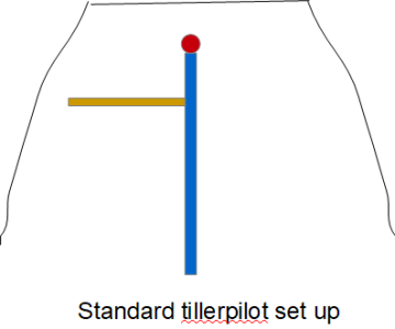

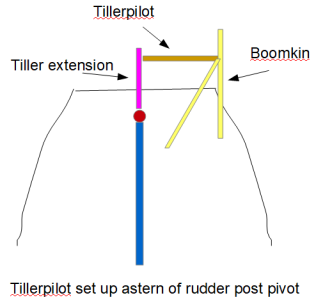

RE; so was thinking of remounting it behind the tiller fulcrum/rudder stock.
Reversing the operation of a tiller pilot is really easy. Just press a couple of buttons. Refer to your manual.
However the tiller pilot needs to be connected to the tiller at a certain distance from the rudder post pivot point and at a 90 angle.
Any deviation from those requirements will effect the power and accuracy of the unit.
Here is the standard fitting arrangement.
If you fit it behind the pivot point you will need to make up a sturdy boomkin.
Not sure if it is worth it
Gary

Yes, that was what I was thinking. I'll take a measure and see if its easily doable.
