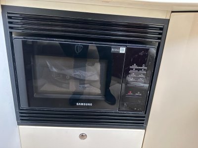

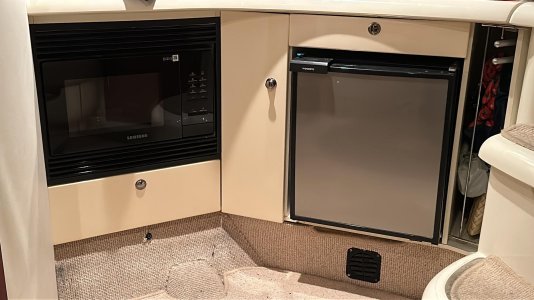

Hi Richard,
Photos below. Took a LOT of research but I managed to find a cheapish Microwave / Grill that was suitable for building in to a cabinet. The original trim kit was 10cm to large so that went in the bin and was replaced by one bought locally in Spain.
This is the model...
Samsung MG23A7013CT Built-In Stainless steel Microwave + Grill 23L, 1100W
I'd have preferred a Stainless Steel surround but forgot to tell my chap.

Thanks Pete, that looks great, was the surround custom made to fit and is it sat on the same shelf the SMEV oven was on or did you need to fabricate a way to secure the microwave?

It seems boat builders have issues with making a microwave installation look okay
There's some challenges. Firstly, most galley cabinets on small boats (c. < 55ft) are 500mm wide. Standard domestic kitchen units are 600mm wide. It's VERY difficult to find a microwave / grill that is suitable for fitting in a cabinet 500mm wide with the recommended clearances to the sides. You have a little more choice if you don't need a grill but obviously that would be rubbish for bacon butties :).

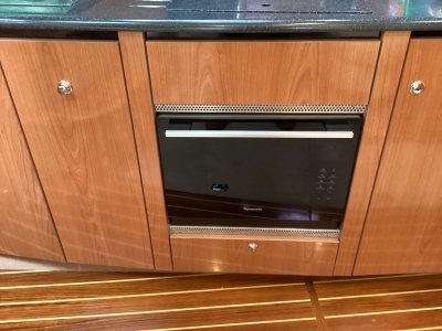

Hi all, I have the same old 30 liter Gas oven in my princess and would like to replace it with a electric oven. Did anybody install the earlier suggested Panasonic NN-CS89LBBPQ and is there an issue with the heat due to reduced space on the side / top ? Any other drop in replacements anybody had been successful with ? thanks

Our P45 is fitted with a Panasonic NN-CT585S, it's a combi oven and doesn't overheat unless the oven is used for 20-30 mins or more with the cupboard above it closed. Open the door ob the cupboard and it's fine. Never overheats using the microwave.
