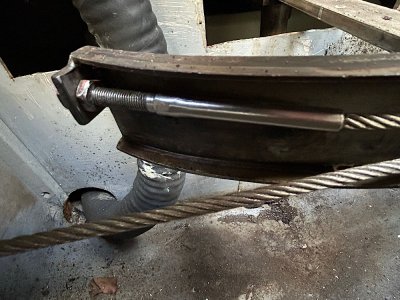

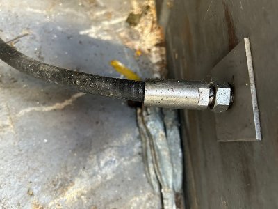

My westerly longbow has a very simple steering system, basically rigging cable through conduit, the quadrant end is swaged to a quite thick threaded rod, and attaches to the quadrant with a couple of nuts which can be used to tension the steering.The other end
winds round the drum a turn and a half and is secured by a compressed ferrule captured in a clamp.

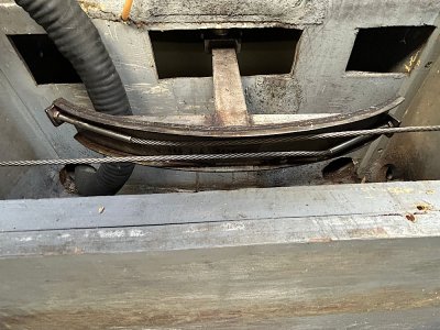

The quadrant
The swaged fitting to threaded rod with nuts

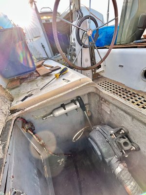

Through the sternlocker into the conduit.

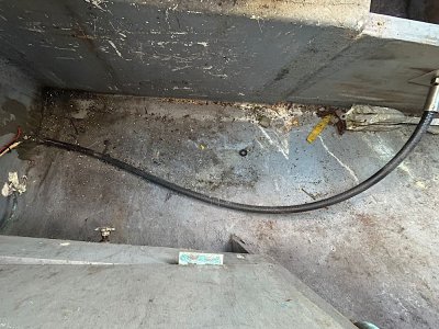

The conduit runs though the cockpit lockers
Exiits at bottom of locker

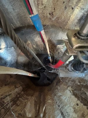

Cable comes up into the pedestal andcrosses over

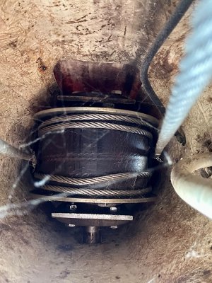

To wraps round the steering drum
This shows how the cable is secured to the drum,( its a bugger to manipulate the drum out of the pedestal)

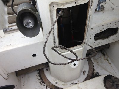

and this shows the state of the steering cable back when I bought the boat and had to fix the steering by gwtting the cable wound back round the drum

So, anyone recognise this and know the name of the steering system? And any suggestions as to sources of large threaded rod swage ends? Or other clever ways of attaching the cable to the quadrant.
Because replacing the rest of the system seems straighforward, its the ends that attach to the quadrant that are causing issues.

Sta Lok was going to be my suggestion instead of a swage. They are slightly larger diameter but you can fit them yourself. They can be undone to shorten the wire if it is too long or it needs replacing again.
I renewed my steering cables on my Moody 33mk2 about 5 yrs ago, very similar system to yours but with a chain around the steering wheel pulley. It was impossible to remove the cable & wire in one piece due to difficulty accessing inside the pedestal. I managed to undo the cable to the chain, cut the other end at the stud and withdrew the cable. I decided the outer cable was ok and replaced the inner cable - with flexible 7x19? stainless cable. The connection for the chain was easy(sorry, can't remember details) cable made overlong. Pushed through the outer tube to the quadrant where I fitted a new stud from Sta-Lok after cutting cable to length. Cable well greased before fitting. I had to re-align one end of the tube as it had a sharp bend where it exited the bracket, where the inner cable had badly frayed.
I had to weld the end before pushing cable through the tube as it kept snagging. Bought the cables from a local rigger. Worked well for me. I also asked Cliff Morgridge but he was expensive and very busy.
