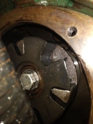

Check the rubber spider whilst you're in there - mine had started to disintegrate but it just easily slides off.IMG_20180511_181924319.jpg

Check the rubber spider whilst you're in there - mine had started to disintegrate but it just easily slides off.View attachment 206939
