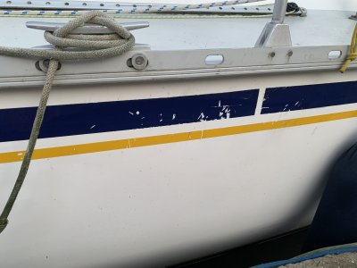

My boat has two stripes on hull just below gunwhales that have the odd bit of damage after 30 years afloat. They’re stickers/tape, (not painted) and I’d like to buy something to repair them with. I’m wondering if there are specialised companies that do boat decals, and what the procedure is. I assume I would need to send a sample of each stripe colour (yellow and navy). Has anyone done this before and if so who did you use? Any tips welcome.

Three very succinct replies! Many thanks. I did consider painting damaged areas Refueler, may still go that route as damaged areas are tiny in the grand scheme of things.

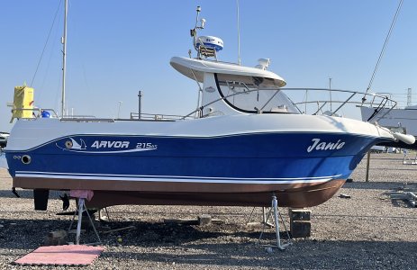

I replaced the racing stripes on my boat, along with the brand decals and name.
The stripes were far more difficult than I thought they could possibly be, they came as a pair on the same sheet but it turned out to be impossible to wrap around the contours of the boat without creasing so I applied separately.
Also it’s difficult to keep them parallel as when they are stretched they become thinner.
After a lot of head scratching we got it done and I don’t think I’ve had reason to look at them since. 14E52181-BF42-4429-A4B2-E0ACB3147295.jpeg

Indeed- I have the company bookmarked. Trouble is my Parker had a one-off colour scheme, different from both the red and blue normal Parker decals.
