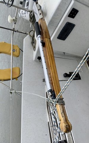

Key the mating surfaces of the laminates, if using epoxy. Gently warm the resin before adding hardener if you’re concerned about penetration. Consider warming the substrate before application. Avoid heat after mixing.
I used one part poly (Compass?) as it’s pretty durable and not too fussy. Bed all your fittings properly and consider an epoxy bush for the head fixings.

Don’t know if you can see from photo but only place I get delamination is in the middle of the rounded bulb at the end and the tapered “cheeks” where it thickens up for the bracket.
10mm seems a very big hole to inject resin but I think I can see the point of inserting a (hardwood?) dowel
