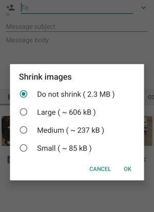

How to post photo from android phone
Apart from other suggestions, click on the photo in the gallery and share it with yourself via email and it then gives the option to resize the image.
