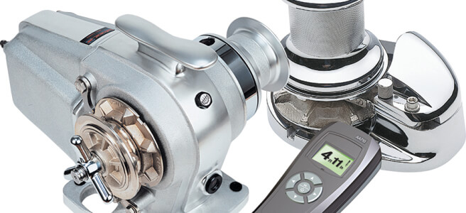

Our windlass is like Vyv's (Maxwell) - it has a gypsy specially designed to take a rope/chain splice - and like Vyv we use all chain. If you use all chain - you would not use the capstan for the rode at all.
This is our windlass assembled and before installation - it does not look quite so bright and shiny now.
And a bit of detail on the gypsy. You can see the pockets for the links and the teeth that grip the rope (if you have a mixed rode).
I really don't understand why you have not told us what sort of windlass you use (and as you are going to post - take a picture of the gypsy). Most modern installations will have a combination gypsy, chain and chain/rope. Often the manufacturer will specify the size of rope needed to 'fit' their gypsy and if you use rope that is too thin the gypsy will not grip the thinner rope and if too thick will not fit either. A simple search will provide you with the spec of your windlass, its gypsy and whether it will accept a mixed rode and what size of cordage matches.
I know many windlass can opt a capstan, we rejected the idea as we have enough winches (2 on the mast) and we have a combination gypsy. Our windlass is below deck and having an, unnecessary, capstan introduces a trip hazard to a 'clean' deck. But the capstan is not only there for the windlass it can be used (for example) to raise sails - it offers you a way to apply power to your halyards - it may be installed but was a actually never intended to be used with the rode (and sounds as if using it for the rode lacks logic with your installation - and maybe your rope portion of the rode is simply too big....???).
