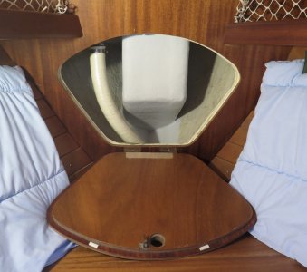

If your current gypsy can't do it, you should be able to find one that will also work with the rope. Mine does. Even the splice goes through fine, though I do have to help it down the hawse hole.
