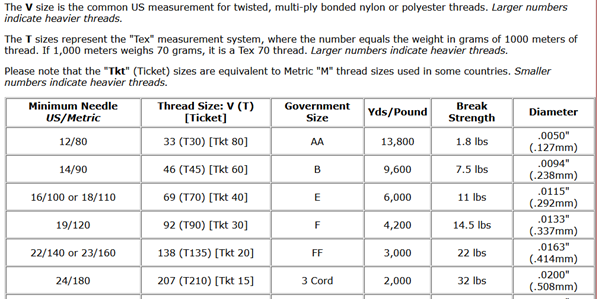

Will the Read's sailmaker sewing machine take a needle suitable for V92 thread?
Correct me if I'm wrong but I think a 120/19 is the size needed

Among the additional information it recommends using130LR1\10. needles which you can find online and, I believe, have a cutting point. It also says you can use Metric 40 or 30 thread depending, don't know how this relates to V92.
Personally I have always used the largest domestic needles and V69 which seems to work ok both on the machine and in use.

You should be fine with a V92 thread (and your suggested needle size).
You will probably find that you have to loosen the lower tension (i.e. loosen the bobbin case tension screw perhaps a quarter turn).. Remember, just enough to just be able to pick up the bobbin in it's case by thread alone..
