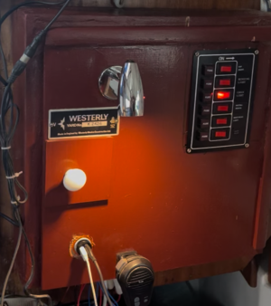

I am getting an annoying and worrying issue with the electrics on my Centaur. The switches for lights, radio, instruments etc etc have been moved to a new position which is easier to view and get to. Below is a photo of the project when it was half completed, there is now a 4 gang set below with 3 switches in use.
What I am finding is this, most of the time when I turn things on they work fine but every now and then the switches dim and sometimes they all stop working. The lights will also dim and if the VHF is on it will go off. The 2 leisure batteries and 1 starter are all less than 2 years old.

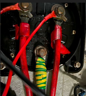

The first will be the one on this little set which goes down to the engine and meets up with the 2 neg cables from the batteries.
I am also thinking about replacing the large neg cable which goes from here
Under the engine to here
Any thoughts please

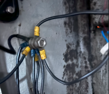

I also had an M6 stud for all the domestic negatives. This was fine when I only had nav lights and cabin lights but as I added more gadgets the stack of ring terminals increased to about 12 high. It was difficult to get enough compression to guarantee a good connection and I have now changed it to a bus bar.
Unless you are drawing a lot of current the voltage drop in the wires will probably not be significant but corroded connections will soon stop your equipment from working. If possible I try to keep all connections inside an IP66 box with cable glands even inside the cabin as dampness can still get to the electrics. These boxes are really cheap now so you might as well make use of them.
Thanks all, I m using bus bars in the new switch box but this stud is on the other side, however I do have spare bar so I will do that this weekend and the cable feeding down to the engine will be bigger also
