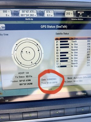

My E120W is showing a date in 2003! 😢
This messes up the tide data etc.

Eeek, so essentially my RS125 receiver has self-destructed by design.
Can someone confirm that if I fork out £250 for an RS150 I won’t have the same issue?

The week number is stored in a 10 bit number, once you hit 1023 weeks, it goes back to zero. Your date will be 1024 weeks ago.
Hopefully it's just the tidal data and not using the 2003 date to derive satellite positions from the Almanac.
