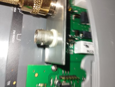

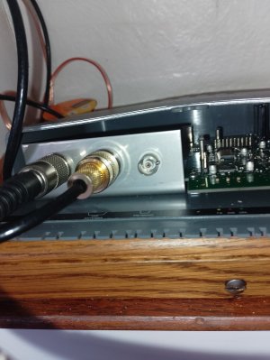

I am installing one of these (bought secondhand from a forumite) and struggling to find a plug for the FM output or preferably a cable with a plug on one end and the usual male type into a Sony car radio. The two are close together so the cable only needs to be about 30cm long.
Any ideas?

As far as I can see, it's a standard BNC socket such as THESE that is needed. It should be a trivial matter to make up a suitable cable. But I am curious as to why an AIS receiver requires a connection to an FM radio!
Thanks. The unit incorporates a splitter with a VHF, FM and 0183 output.
