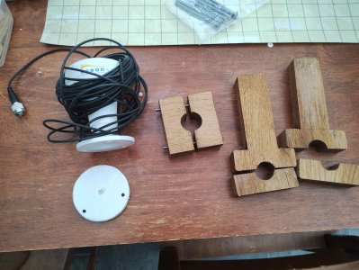

Ooh, being a practical boat owner, one of this weeks jobs as it happens. Might be a bit low rent for some with a shiny new boat.
7cm square of 25mm oak board (other woods are available), holesaw to suit tube diameter and cut down middle, preferably with a chop saw with some kerf to make a small gap between the two pieces.
Could be smaller/neater but you get the idea. I already have a couple in use for nav lights, these are for an AIS GPS antenna and solar panel support brackets.
You can then screw or bolt whatever you need on to the oak bracket to suit the purpose. The disc of painted marine ply in this case will attach with small SS brackets and the AIS antenna bolts on to that.

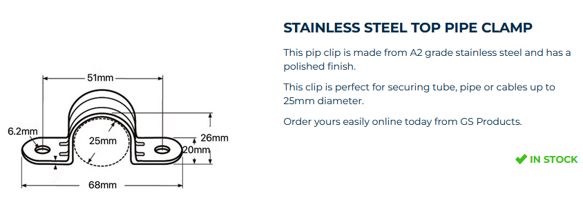

Look up Stauff clamps available from hydraulic suppliers.
Or this:
Stainless Steel 25mm Top Pipe Clip | GS Products
Looks like you need a 50mm hole pitch and then find a clamp to suit your pulpit pipe diameter. Some rubber packing could take up a small difference. There may be a small advantage in allowing it to swivel under load to avoid damage if the pulpit comes into contact with the boat in front.

Thanks ridgy, always love a proper PBO style solution! Looking at the picture, seems like your solutions are either for a horizontal plane (GPS) or a side facing solution (tube runs at right angles thru the wood). I need a forward facing solution where tube is at right angles to the light direction. But agree, this concept could be adapted for that as well, I'll have a think.

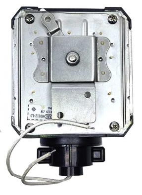

This is the back fitting on the AAA ones

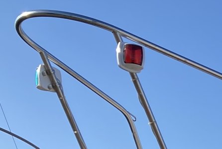

First part I ever made was a metal bracket to mount a new bow light on the pullpit rail.
It was easy enoigh to cut bend and drill some thin-ish stainless sheet. Perhaps 2mm or 3mm. Lined up with the existing holes on the rail.
I have a wooden bracket for my stern light, but it slides aroumd too easily. I must put some sticky stuff on it, or make another metal bracket, or perhaps a grub screw to keep it in place.

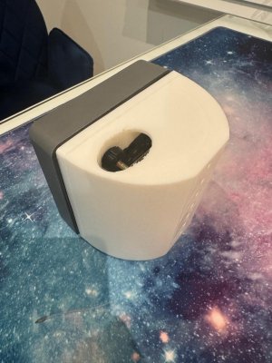

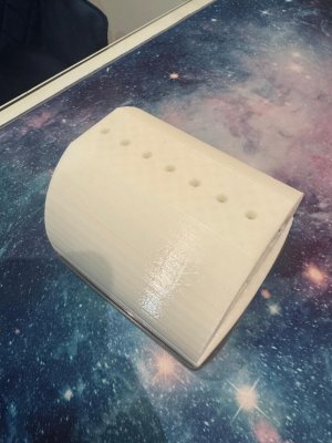

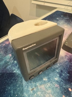

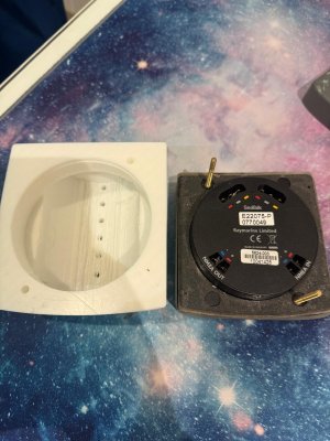

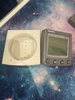

I wanted a mast mount for an ST60 Instrument on our racing boat. Nobody makes such.
It would literally take about 20 mins to print something for your Hella lights

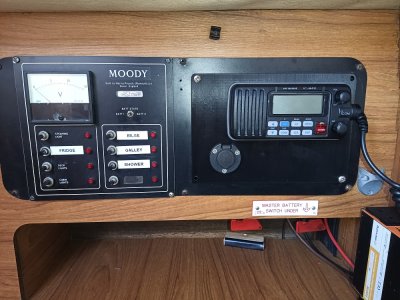

Also made a VHF mount in the past for a Moody 28
I've had mine for 4 years now. I would not dream of not having one.

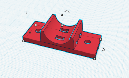

Also to add to this. Most manufacturers post drawings or 3d models of stuff on their websites. It was easy to find the base of the hella light
Lots of people out there offering 3d printing services. If you can think about it, and do a rough drawing something will be available
Just had a play on Tinkercad and knocked that up.
