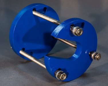

I made this from 10mm plate for my feathering prop:
Not sure how the Featherstream is built, but on mine it is essential that the pulling force of the fwd plate is placed on the actual hub and not on the gear housing. Because of this a spider type of puller would not be appropriate.
