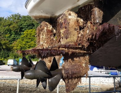

The picture below is the first year I used SeaJet on my aluminium props, you can see how this looks after 1 year in the water especially compared to the legs.
Last year I also used SeaJet on the legs and after just over 1 year in the water there is only a brown slime on the legs and the props are still clean.

That looks like a really good result. Can't really do any better.

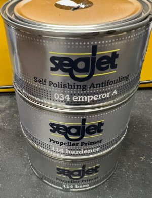

Thanks for posting. Which Seajet antifouling? They do at least 4 types, and which primer?
Goog point......
It's 114 Base mixed with 114 hardener and then multiple coats of 034 for the top coat which I apply using a small roller.
Although the tin looks small it is enough to do 4 duo-props and 2 hubs.

That looks excellent and way better than I have ever experienced and I used Seajet on our S34 👍
Did the boat get a lot of use at sea during the year she was in the water following application of the anti-foul to the props?

I expect prep is the key, I rubbed the props down with sandpaper, cleaned with acetone and then applied the epoxy. (2 coats)
I probably did at least 3 coats of the antifoul, since it had to be used up or thrown away.
The boat gets used only at the weekend, probably only 100 hrs for the year.
I will lift in April and update this thread as to what the outdrives look like, since this is the first year of using Seajet on the outdrives. This is the 3rd year of using Seajet on the props.
Sounds as though you did a great job as it still being there after 100hrs is pretty good to my mind!
