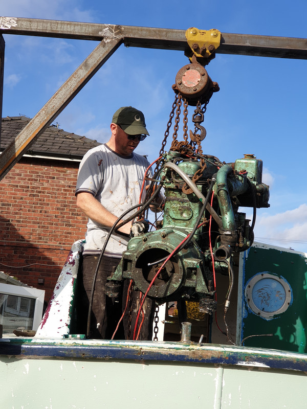

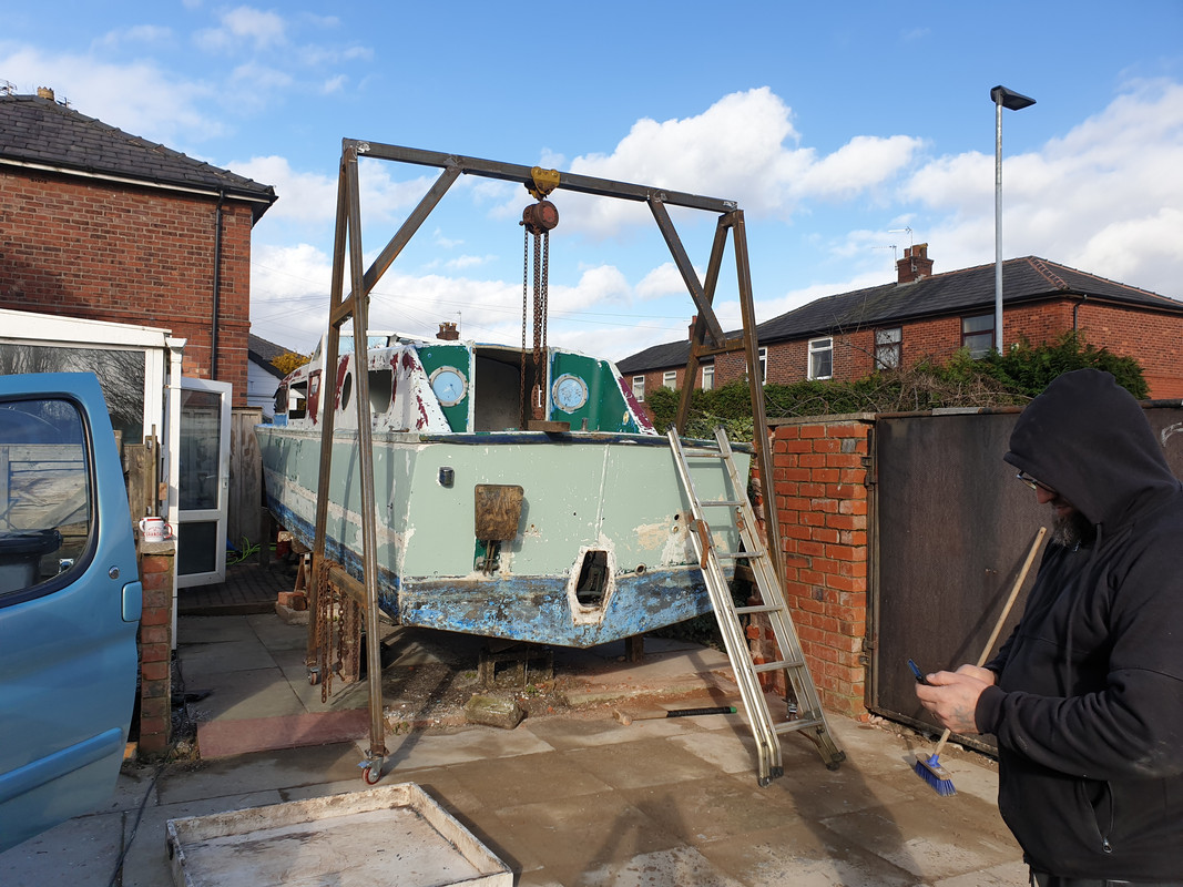

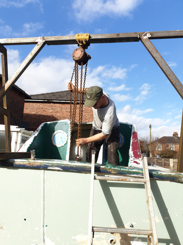

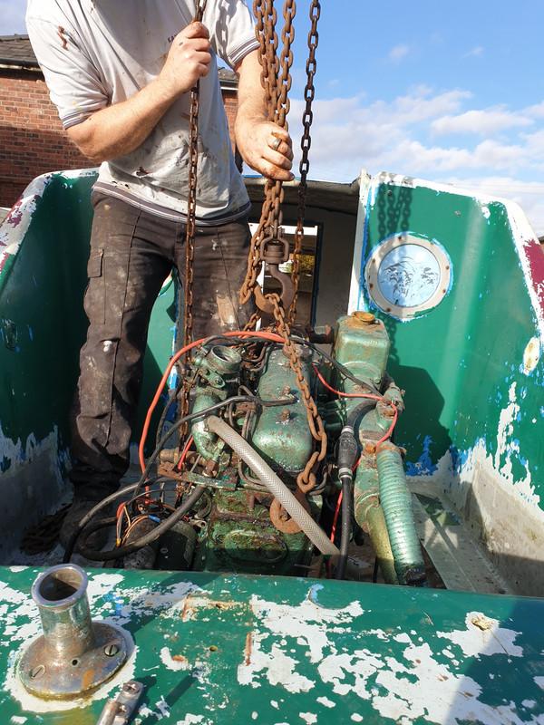

As i am removing the engine and think that paying a crane to come in to do it for me i though i would make a new Gantry. My other is a bit small at 7 foot high as i need 10 foot to get the height needed. So i cracked on to build a new one last week.

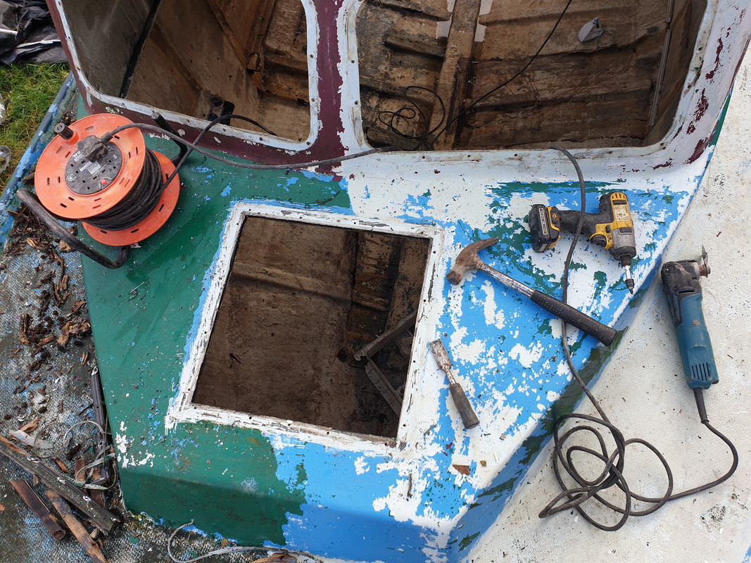

Oh before that though i removed all the windows then started to clean them up a bit and cleaned more of the boat out.
I used my Multitool here to break the seal of the windows to save bending and time removing them. A steel cutting blade is good if you get some screws/bolts that will not come out.
See the difference here, right side is pressure washed.
So the new gantry fits just nice.

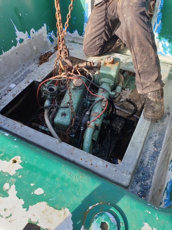

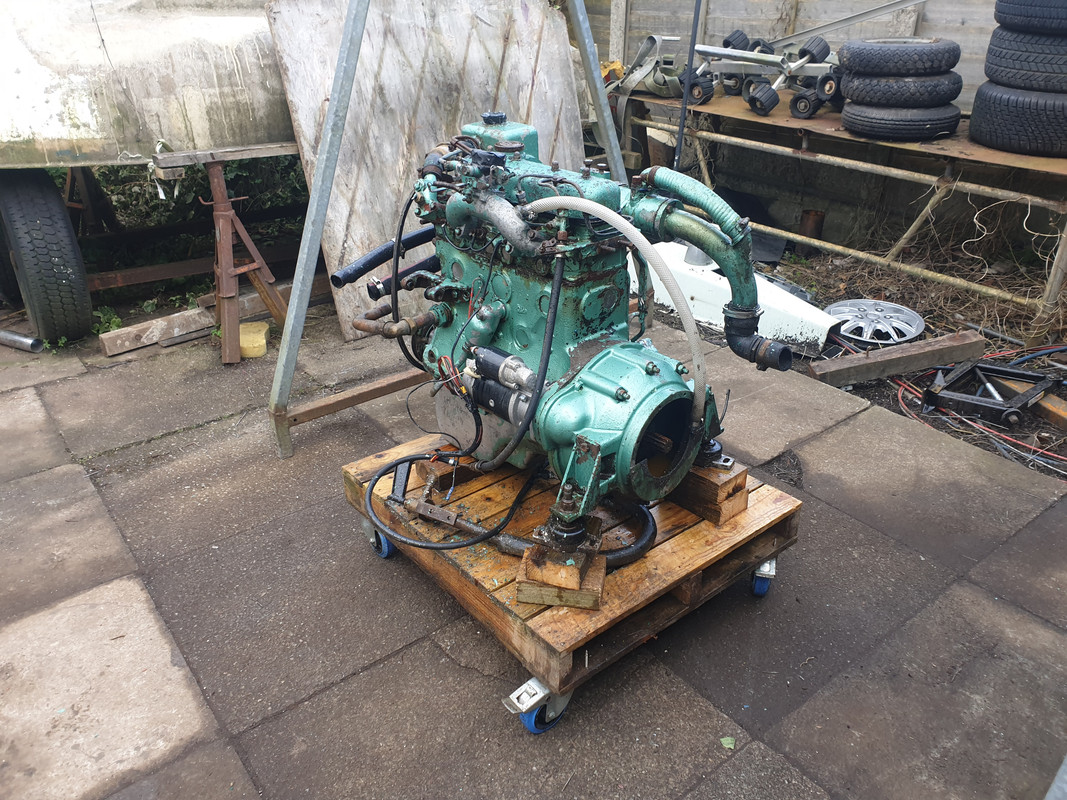

Its only a 4cyl diesel but dam its heavy, had lighter V6 and V8 engines to play with. But then its an old thing at near 50 years old now.
It was a lot easier with the girder trolley and gantry on castors, struggled in the past with out.

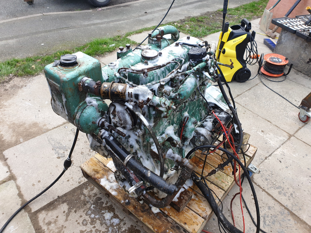

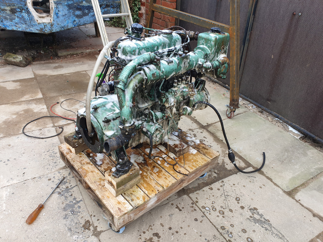

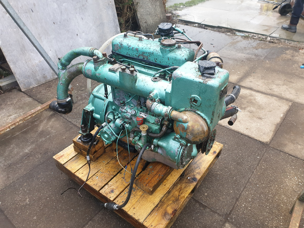

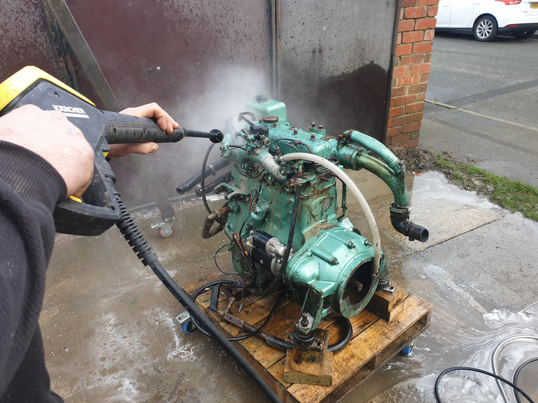

Got the thing out then before i wheeled into the pound we gave it a wash down with some TFR.
Come up nice i think. I wonder if it has been washed down in the last 50 years ???????
Plan for now is to just strip off the intercooler and what not then paitn strip it to give it a new coat of original paint. Find a side entry inlet manifold so i can get a lower engine bay lid. Unless i do what i plan to do :):)
Oh yes, these engine have an exhaust lol
Forgot to detach it so halfway through the lift the hacksaw came out :)
That looks so feeble for weeks of it. Although i feel i have been working on it every day. I have struggled still with one eye to build the gantry with welding. One of them jobs that go.....Weld ....grind....weld ....grind.......weld....grind.....have a moment and a brew....weld ....sod it that will do :)

looks good W!
I particularly like the green stripy waterhose connecting the heat exchanger to the measly elbow, hope you keep it :p
Mixing elbow looks odd, not really mixing anything is it?
I guess it goes straight into the outdrive and there's no exhaust hose involved, right?
Are you going to rebuilt the engine or just service and cosmetics? After the miles you've done in the canals, you must have an idea of it's condition, right?

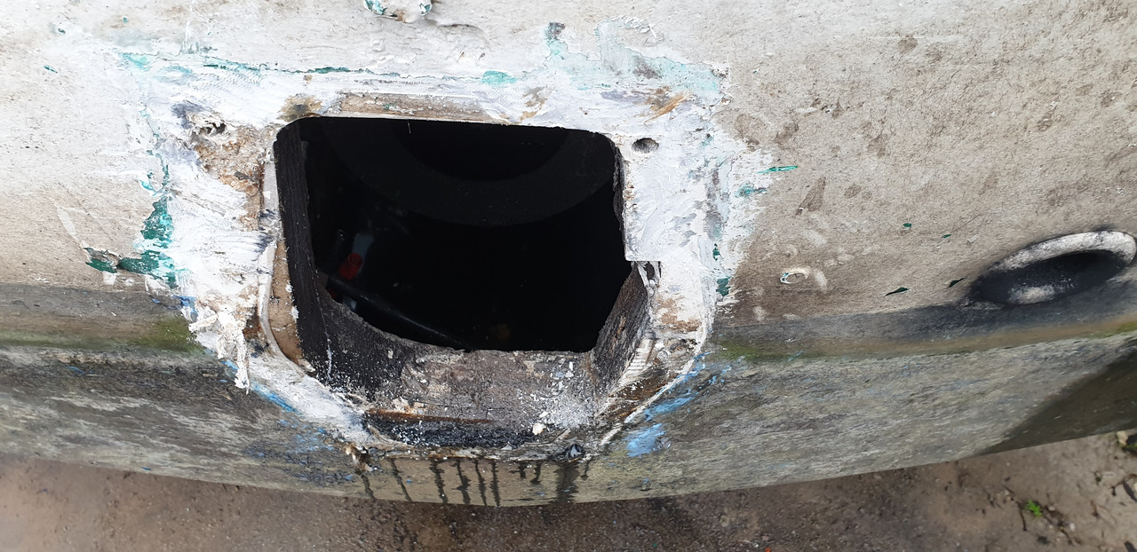

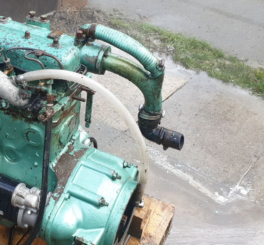

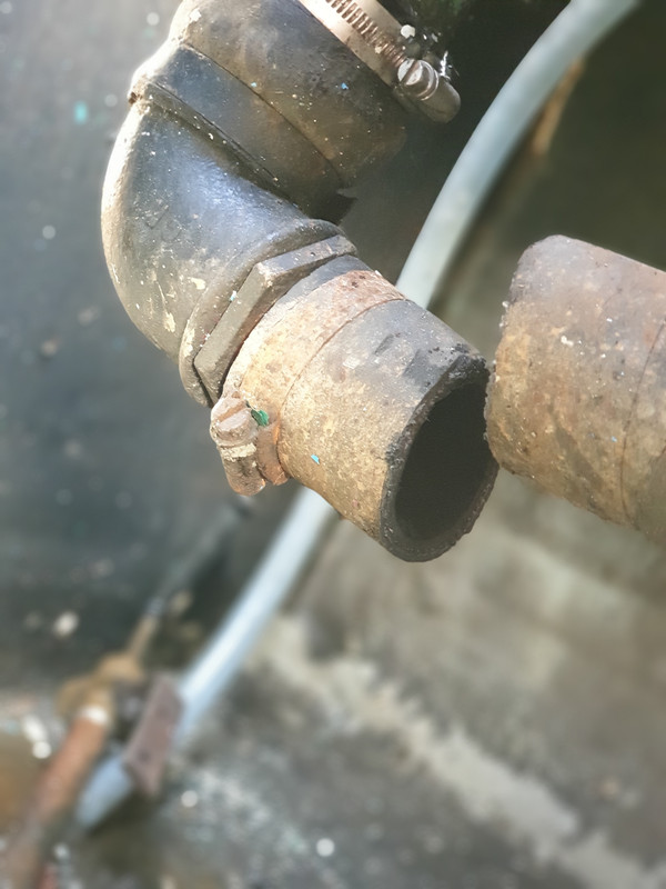

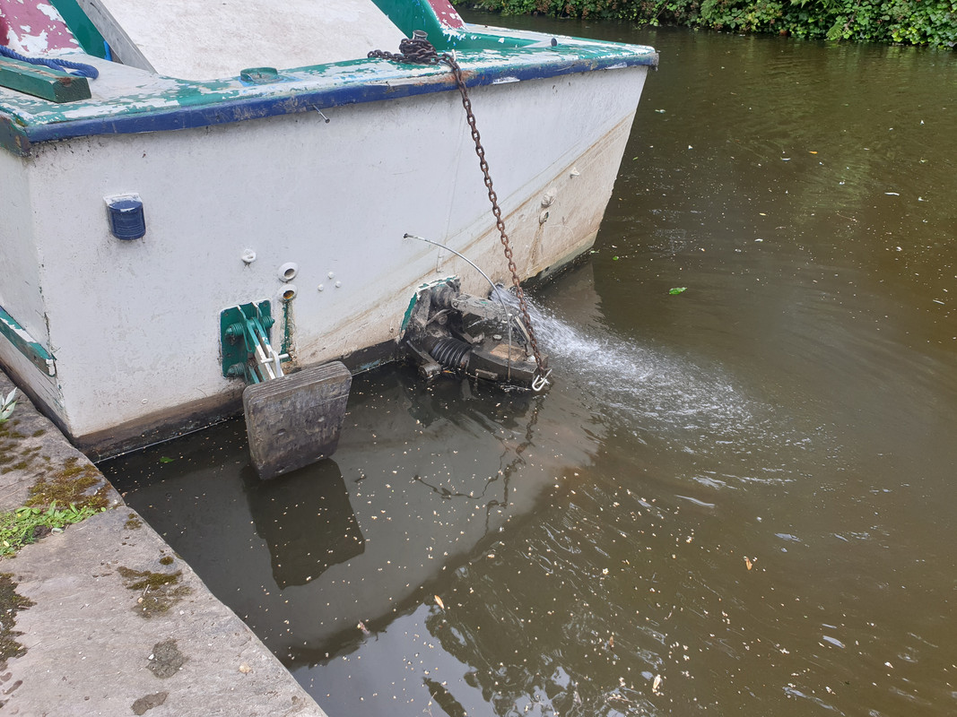

This pipe ;)
Hey even more clever tech stuff, i managed to zoom in for you can save the pic ;)
Not all that up on inboards, well heat exchangers not that clued up but engine yes, i get how they work and what they do.
So `mixing elbow going into the outdrive ` ?
The exchanger and exhaust just goes direct out the transom. hole on the right
So the exhaust is the rubber pipe i cut off at the end of the green stripy pipe junction.
I wont be stripping the engine as it runs great, like you say, i had a good run with it over four weekends non stop, doing 8-10hr cruising.
Its a pig to get started if you get air in the fuel line, like when we ran out of diesel. Going to see about fitting an electric lift pump to make it easier.
So just to remove the heat exchanger and all ancilleries and clean up more and repaint it all.
Then bench test it just for the crack :)
W:)
vas
21 Jun 2011
7,915
Volos-Athens
ah, OK
now looking at it closer, judging from its thickness, it's probably a proper exhaust hose, just painted on the green flaking a bit, looks OK .
thought it went through the shield or what you call it. OK, in your case it goes straight out and above w/l, so fine but wont be quiet for sure!
maybe think about fitting some sort of silencer (vetus does many) if you have space to route the hose to stbrd, put a silencer and then go out through the transom.

I was planning on doing but hell, you heard it havnt you :)
