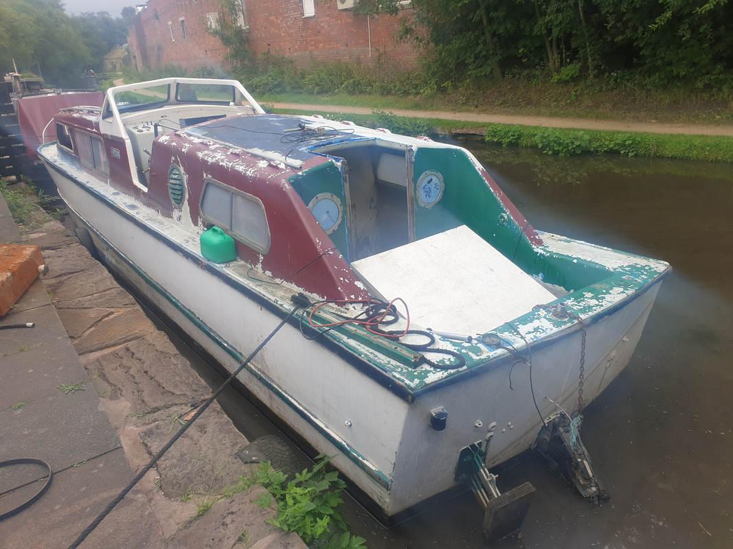

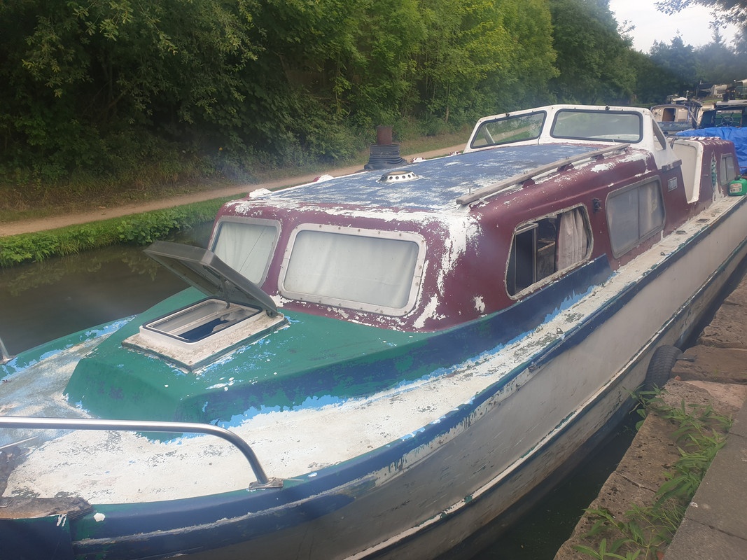

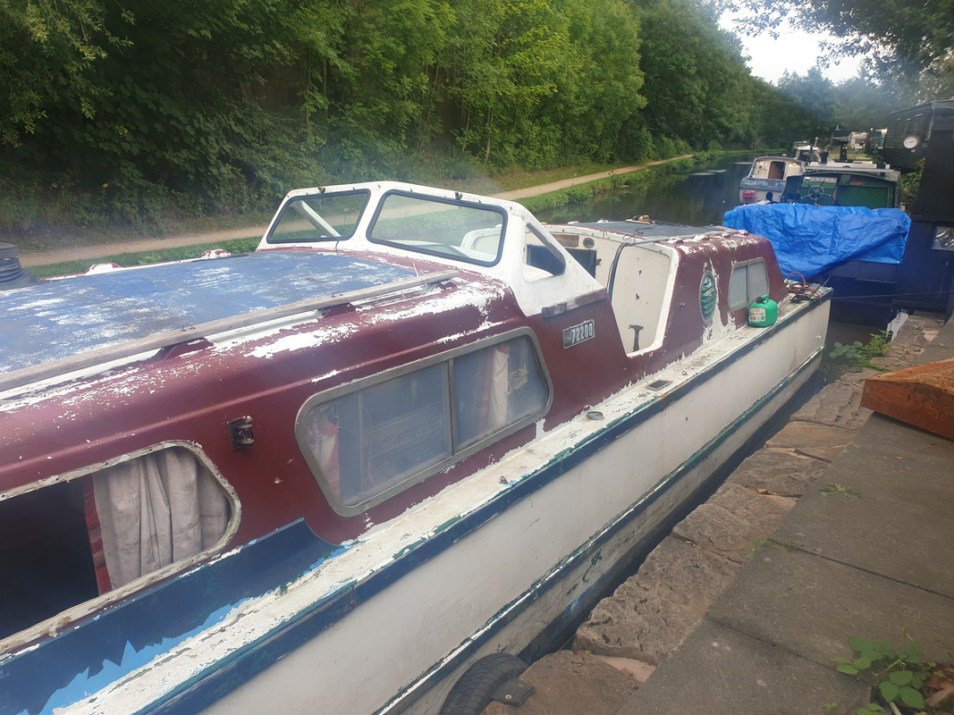

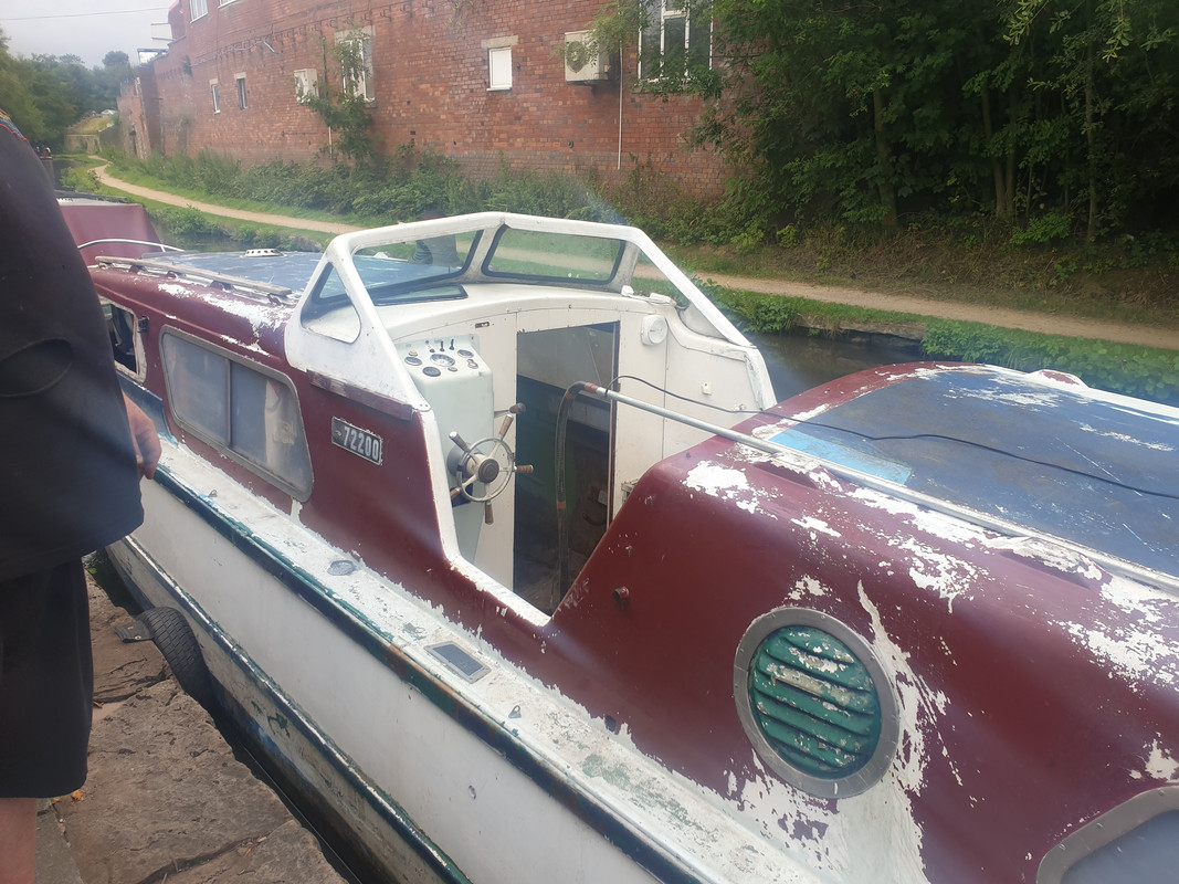

This is a Norman 32 6`10" beam cabin cruiser. In need of much work, but less than the Buckingham i did last time. Trust me it does....i think :eek:

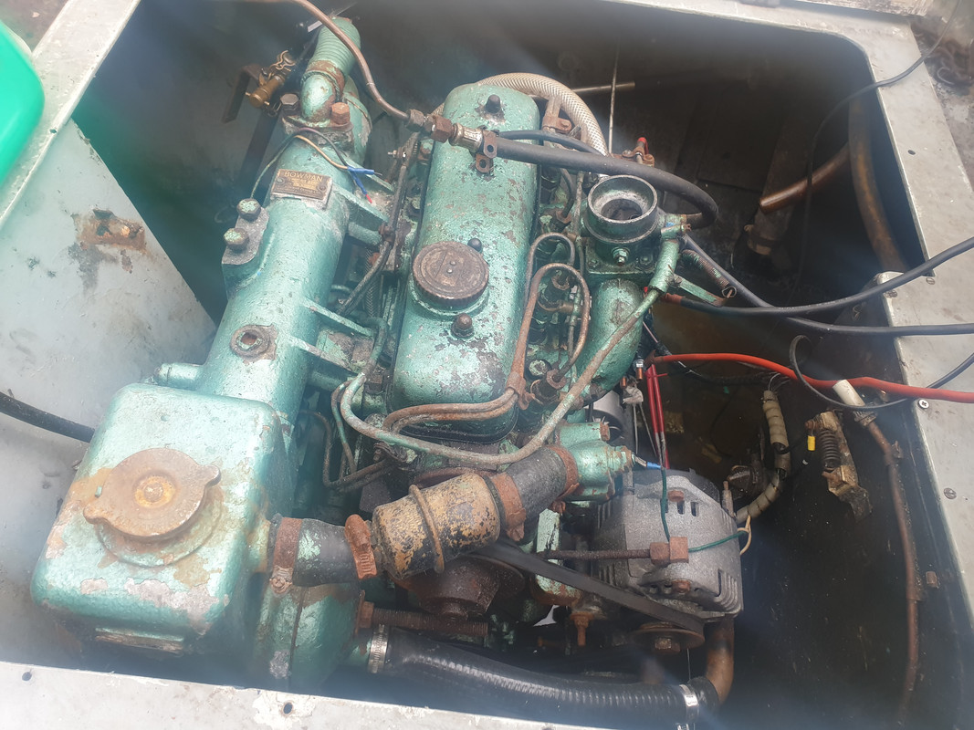

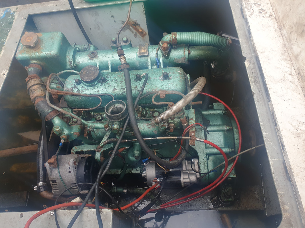

The engine which is a Mercedes OM636 with outdrive / Z drive runs great, needs a few things like air filter and a good battery for now to get it to the home mooring i have for it a few moorings up from Khahsoggi.
It has a new starter motor a basic service and Inj pump refurb
Sounds well once it got going but when viewing the seller didnt bother to preheat the plugs for some reason so smoked like a good un.

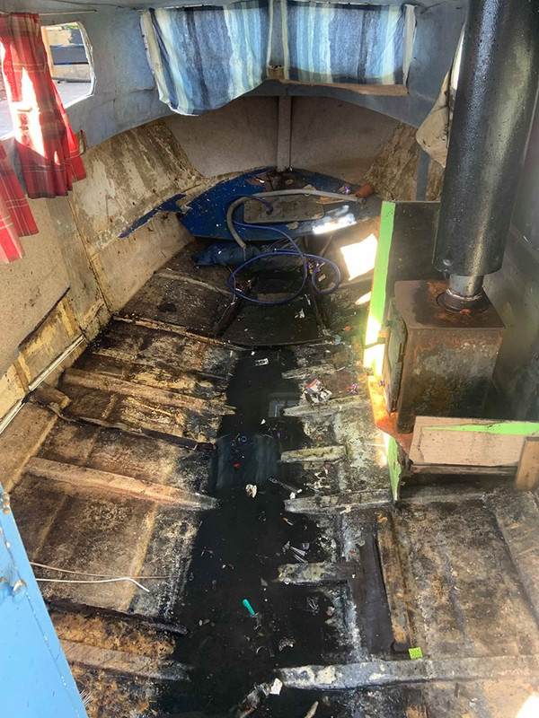

Get it to the mooring and rip out whats left needed to be done, not a great deal left. But i will be taking down the inner skin of th cabin top as its got a ply inner top, sandwich construction, this will be redone by adding ribs in place every foot or so then to save head room by a good 20mm i can insulate it with spray foam this time,
Windows are all coming out and getting toughend glass to replace the plastic naff thats in there.

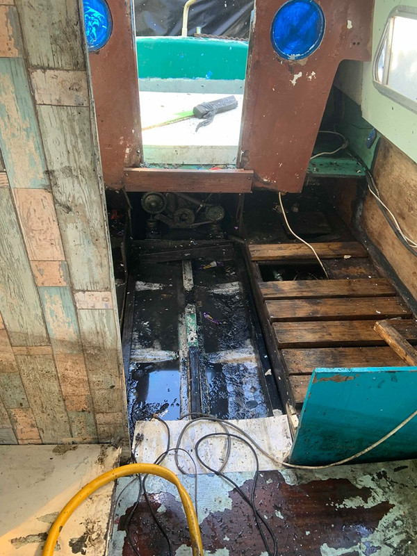

Well as you will see there is water in the bottom, i have three bilge pumps to pump out the boat once out of Manchester, saves homeless folk and squatters taking over if its full of water. Then this will i hope see if the leg has any leaks or exhaust etc. Still i will be dragging it out locally to redo them all an d remove the engine to clean it up and fit a drip tray etc etc.

Well, errr, that's a much better project than the Fisher 37 you looked at! It's floating. The engine sounds OK. The superstructure is in place, and once painted should look smart. There's just the interior to construct; once you have it dry and clean inside that shouldn't be a major problem. Enjoy it!

Awesome Wayne. I really like the lines of your boat.
Has a sort of MTB look to it :)
