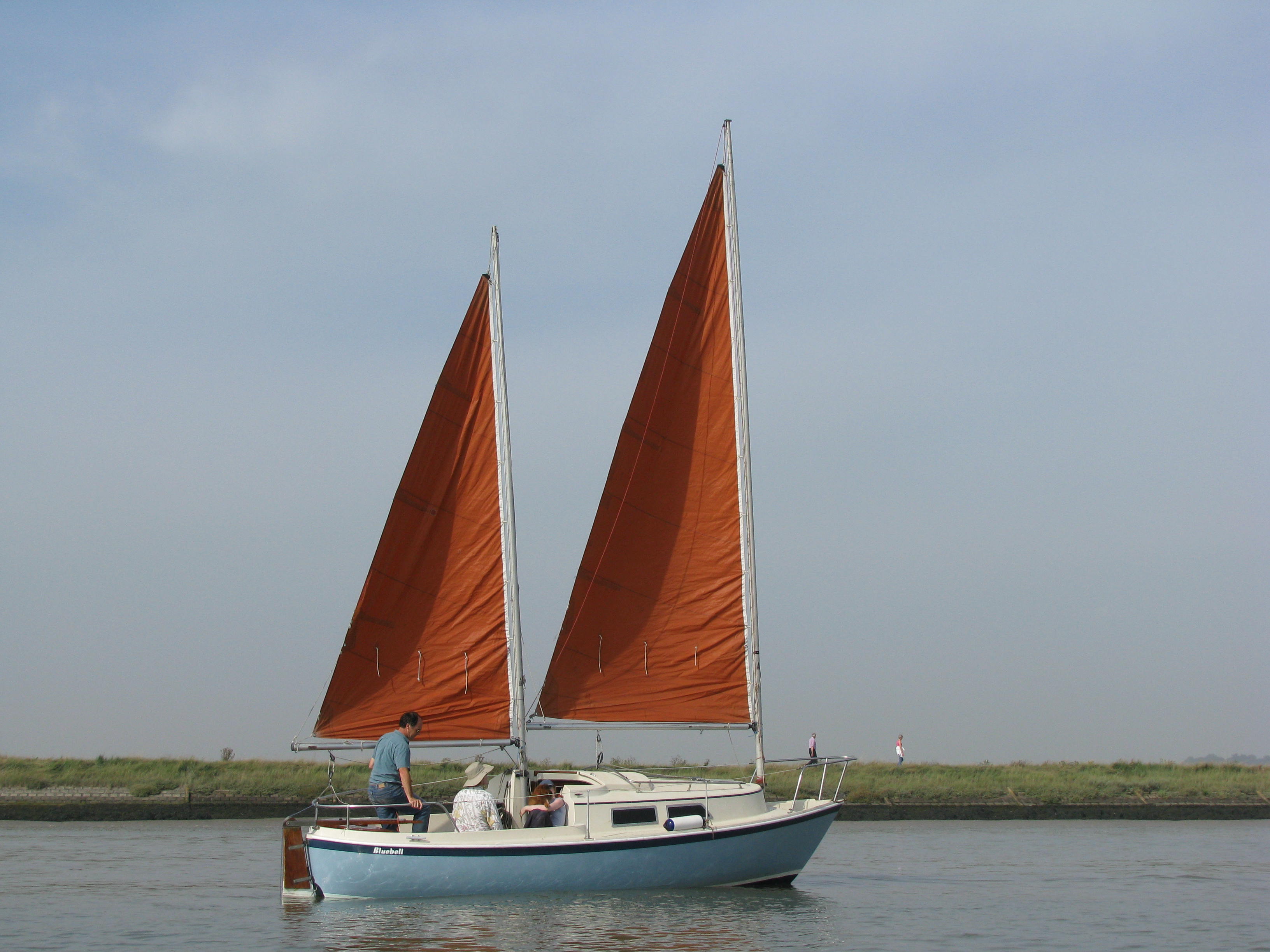

How about a Hunter Liberty 22? Flat bottom, lifting keel, stayless masts, 540kg empty. Friends of mine sail one from Kirkcudbright and like her very much.

The displacement figures for the Liberty are all over the place... worth trying to find out the true figure?
Our Liberty 22 with masts and sails but without anchor+chain and outboard comes out a millitad over 1000Kg. On trailer but still without anchor etc is 1500 kg.
The later version known as the Liberty 23 is 100kg heavier. Our trailer is a single axle without launching dolly.
Hope this helps?
