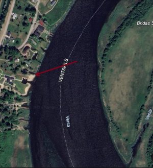

Understood ... but strange as it may seem - the area to clear is split into two :
Here is the general layout of my channel in relation to the bend in the river ... flow of river is from bottom to top ...

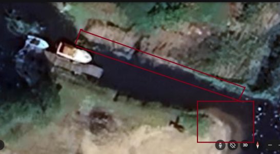

Now zoomed in you can see that the shallow bit (red square) is actually on the UPriver side - not on the downriver side as you'd expect.
Blowing would likely cause transfer to the other side of channel - possibly just widening the problem. It needs to be piped to the downriver side and out into the river to ensure it does not collect.
You can also see the long red rectangle - that is also shallow and needs removal ... the grass / reed cutter could only surface clear the growth .. we still have the growth under the water - ready to appear again.
