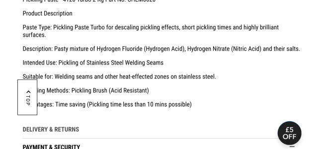

5,360
Please post a spec sheet or MSDs. I'm interested, but the chemicals you listed don't make sense.
(Hydroflouric acid is generally very aggressive and dangerous because of extreme toxicity, and I'm guessing the other might be nitric acid, which is used for passivizing stainless, although citric acid is taking over because it is safer and just as effective.)
I an no chemist so this is from manufacturers descriptiion ( tap to enlarge 👍)
Wow. The writer's use of chemical names is ... interesting. Hydrogen acid, for example, is an ambiguous reference that can mean several things and would not be used by a chemist.
Wear two sets of gloves. That is some dangerous stuff to get on you. Not worth having in the shop IMO, and I like chemicals (chemical engineer).

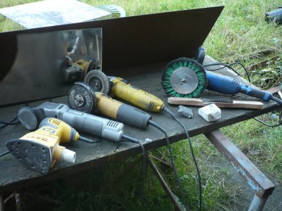

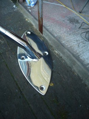

Anyway, back outside the chemist's shop. This is my polishing set.
The first pic' is all the tools. The stainless sheet at the back is something I am working on at the moment as it is often easier to do the initial polish before cutting and Welding.
The second pic' is a typically awkward piece to get all round when polishing and this is where the multi-tool really excels.
View attachment 183528 View attachment 183527
Mmm , shiney shiney 👍👍😎
