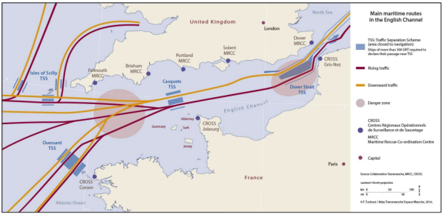

I've not been to the Channel Islands by boat before and looking at 17-22nd August (all dependent on availability of dog boarding!). Seems to me best route is from Plymouth to the SW corner of the TSS, to avoid crossing same and then head E to pick up suitable approach angle to Braye Harbour. If I time this to arrive at Alderney just before/around slack water Dover, I'd get a good push from the tide from the turning point.

I think our plan is to head from the other side of the country…leaving maybe from Ramsgate or Cowes…and we’ll cross in the area north of Cherbourg to hit the Alderney race and swing around south as it slows.
We’ll check the tide tables/atlases and plan departure time around this.
As another note, I’ve liked the areas between the TSS because it gives better sailing angles (not restricted to 90deg heading to it) and you still have reasonable expectation of most traffic, as they *tend* to follow the paths between their TSS lanes.

We are also considering Plymouth/Salcombe to Guernsey in a few weeks. It looks like it would be a night crossing passing thru the western approach to the TSS. Question..is it worth investing in an ais transponder? I feel it probably is, if just for peace of mind given the volume of traffic and expected time of day. We have a receiver and can display vessels on our plotter. We don’t have a radar but do have an inflatable echo max reflector that we would hoist.
