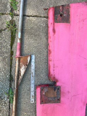

Hello everyone, I have recently purchased a Pegasus 800 no.6 and of course it has no rudder due to being left on a mooring unattended for some years, can anyone please help with maybe a pattern or a replacement from a donor Pegasus 800 thank you all so much in advance.

We use to have a Pegasus 700 which has a similar rudder I’m sure. The rudder is a simple affair shaped from hardwood. The leading edge is shaped to fit around the 25mm stainless rudder shaft which had a triangular tang at the top which slotted into the rudder. There was then a shaped length of wood that ‘covered’ the rudder shaft and was glued into place.
There is a little bit more to it but not much. I probably have a shed load of photos if it is of any help.
