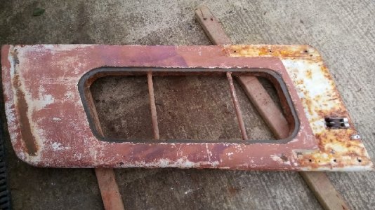

Another Keel question I’m afraid. Having owned my P21 for only a few days now I have found that whilst out of the water, lifting the keel takes a bit of doing. Much harder than I had anticipated in fact (but then I have nothing to compare it to really being that I have no experience with lifting keels). I intend to take a proper look at things over the coming days but I'm just curious - should the keel be fairly easy to lift (strength wise)? Will it lift easier whilst in the water? A silly question perhaps, but any advice appreciated. I'm also wondering what, if anything, is good to use to aid this? (grease etc?).

'Will it lift easier whilst in the water'
yes, the weight of the keel will be reduced by the weight of the water it displaces
just like your boat dispaces water, that makes it float

Well, maybe a bit easier when afloat. But other things to check:
1. Early 21s had a 4 to 1 purchase (2 blocks on the keel), later ones went up to 6 to 1 I think.
2. Do the blocks still go round? They may be old tufnol blocks with plain bearings; new blocks with roller bearings are better.
3. What's the diameter of the uphaul line? 12 or 14mm is harder than 8 or 10mm, and dyneema is plenty strong enough.
4. Lubrication: PTFE spray is better than grease.
My keel is still on 4 to 1 but it's easy enough to winch up - about 60 pulls, 4m of rope to lift it. The uphaul line is 8m overall.
This is what an early keel casting looks like, with the 2 tufnol blocks:

Some great pointers, much appreciated. She was made in 1990 but I’m going to get a better look at the blocks/keel today. Thanks again.

Hi, interested to see the photo of the removed keel. I am looking to remove the keel on my Parker 21 (has the rope purchase system). If you have any advise on the process of removal and refit would be much appreciated

As a Parker Seal Association member with a 26 MK2 I recommend that for all sorts of technical detail you join the association for £15 and get access on the website to the wealth of stuff both in the technical manual for the 21 and the impressive queries,comments,answers over the years including those from the builder.There are numerous items on the 21 keel and possibly one specific to your query.If already a member you could post on the forum.I see there are about 23 no.paid up 21 owners.
PS My keel is a mere 160 kgs.To remove it I deploy the spinnaker pole ,lashed around and to the mast at the ring and resting on a protected deck forward, as a higher independent lift point above it plus the mainsheet tackle and use of halyards for ' tie off ' points.A simpler lifting point can be provided by sheets lashed between the same points and the mast tied back to a stern point. You don't have to be ashore to do this if say the gear is fouled and it is calm.
Conversely you might deploy the yard or club crane or I suppose a tree.
