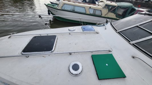

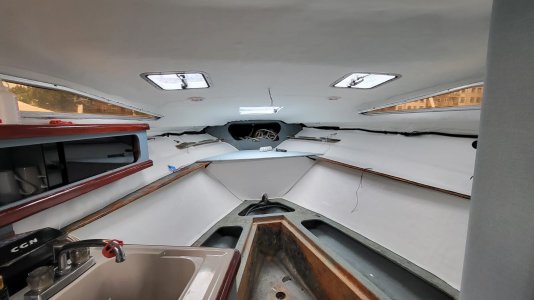

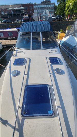

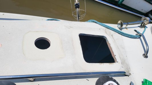

Hi, I checked this now I remember the state I was in. So in the end I gave it a good scrub off with paint remover and wire brush on the end of a drill. I removed all of the old liner and cleaned the black mould. And then used the spray on glue and installed the liner. We didn’t paint under because didn’t see the point. HOWEVER we realised that the old Searays aren’t build for British weather and if we didn’t have ventilation the problem would reoccur. So to everyone’s horror my husband drilled 2 round holes in the top and we installed solar powered vents. That worked a treat! And we also bought a proper de-humidifier and had it on a timer, together with an oil filled radiator also on a timer in the winter months. So there was no more condensation or mould. here’s some pictures. Also had to refurbish the hatches as you cannot buy them from anywhere and we replaced the panes and seals too.

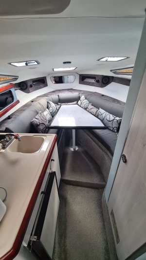

And here’s the new liner. 6mm back foamed I believe it was. From car dealers, it’s essentially the same thing. We discovered whatever is for “boat” or 3 times more expensive than if you say “for a car” lol 1000020559.jpeg
