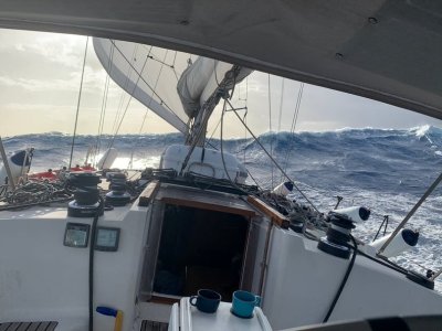

Thanks for your reply .My solution might be a new Genoa with no overlap,set on the furler and later add a code one type sail,much of the ria sailing is reaching in the rias
This is close to what we have - a high footed (see photo) non-overlapper so we can easily see under it when fully rolled out and a cruising chute for light winded downwind. That is so much easier to handle and only leaves the gap of light wind upwind -and probably lose less than a knot then anyway as calm seas means the boat is easily driven. But lumpy seas and a light headwind mean the compromise of the engine.
Wow! Am I the only one NOT looking at the sail in that photo!? That’s some sea state.
And if I say that photos always flatten and calm you wont be surprised that firstly it was very noisy and secondly that I was in deep admiration that my wife should keep us going with hot drinks and full meals day after day until it subesided.
But the sail plan worked well.
