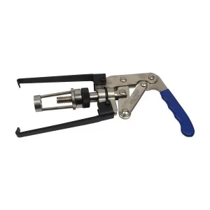

Hi Guys, I'm intending to change the valve stem oil seals without removing the head.
There are several tools available but my reasearch has mixed reviews across all of them.
This is on a TAMD63P.
I'd be grateful for recommendations of a liked tool, or one to avoid.s-l1200.webp currently edging towards this one.
Thanks.

The OP wants to change the valve stem seals without removing the head. While I’ve done many head rebuilds, they’ve always involved removing the head first. The only time I’ve seen stem seals replaced with the head in situ was on Wheeler Dealers where Edd China used air pressure through the spark plug hole to keep the valves in place.
Grandad showed me how to do this when i was about 10 years old, take spark plug out, turn crank to BDC, feed a few feet of string through plug hole , then slowly rotate crank towards TDC, hey presto ,valves held in place , remove collets by smacking a appropriate sizes socket on the retainer, change stem seal and then repeat for other cylinders ;):D
I have a compressor, and a dummy injector, but have also considered the rope-trick. Still undecided.
It's a little more difficult to do the rope trick through an injector hole in a diesel.
On my engine it'll probably be compressed air.

I'd be grateful for recommendations of a liked tool, or one to avoid.View attachment 202903 currently edging towards this one.

I'll get the one in the image and see how it goes.
