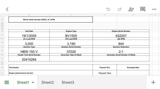

UPDATE: Called Beta who were helpful as always and advised that this particular era of Beta 38 had a max tested idle rpm of 3,190 not 3,600. They provided the test data sheet from 2005 (attached)
So they were happy that given the age of the engine, 3100rpm in neutral is close enough to 3190rpm. They felt that while perhaps a little overpropped, it is likely to be steam and not smoke and not critical.
Nevertheless, this thread has provided a long list of basic engine checks that I will do - would be glad to reduce the steam/smoke and get up to hull speed under load.
