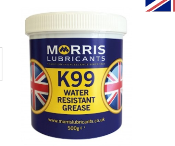

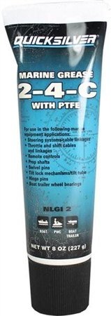

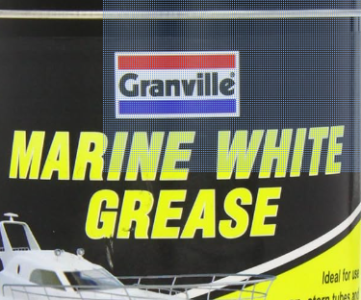

I use white marine grease on the prop splines and also on the driveshaft .
The props come of easily after 2 years. I used the same recently o other components .
The Granville tin came to hand first although I have some K99 somewhere. .

No. Duralac and some PTFE greases already mentioned above for outdrives. Duralac hardens though. No more lost gearbox covers etc. The other two are more for engine where many are into aluminium fittings. Intakes, water cooled exhaust manifolds and turbo bolts.
