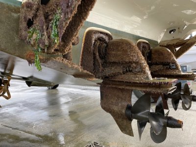

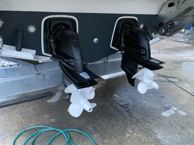

I used this on my outdrive last year on the Beaulieu River and there was virtually no growth just a brown stain on them after a winter on little use, so happy to recommend the Seajet prop antifoul. its a two part epoxy base with a grey antifoul top coat. a single pack does one outdrive and prop.
SEAJET PROPELLER TRIPLE PACK VOLVO PENTA DARK GREY 0.5L
Thanks for that, I did see on another post here that it was recommended, I think I'll go for that.

Thanks Graham, wow that looks like a lot of growth, did it come of easily with a jet wash?
thanks for the comment regarding the rams, I didn't think of that, glad I mentioned it!
It did jet wash off mostly, but needed more rigorous scraping in places. Not a DIY job for me, I’m happy to pay a professional. Same guy is doing my 460 Coppercoat this season. Excellent work, I’m happy to recommend if anyone wants to know.
